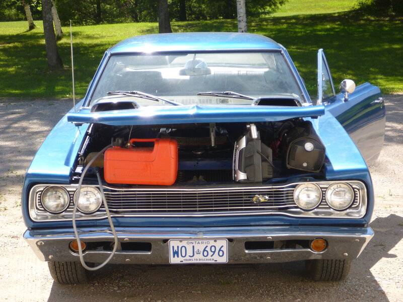

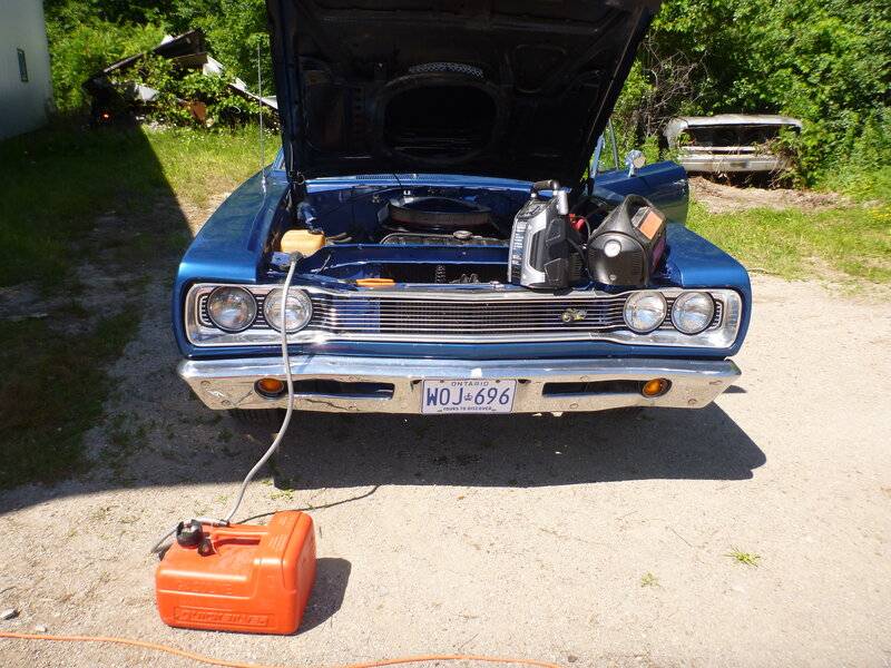

Easy way to get it home so you can then work on it there, get an outboard tank with enough hose you can set it on the passenger floor, hose out the vent window and into the engine compartment. Take the inlet hose off the fuel pump, clamp it and hook up the outboard tank. Worry about the crusty tank when you get it home.
View attachment 1105695 View attachment 1105696

The gas can idea is the best way to get it running. Buckle it in so it doesn't spill. The original tank is a clog waiting to happen.

Gas can inside the car? Not a safe thing to do in case of an accident.
Put the secondary tank in the trunk and hook it to the factory fuel line. Go through the sending wire hole in the trunk with the fuel line.
