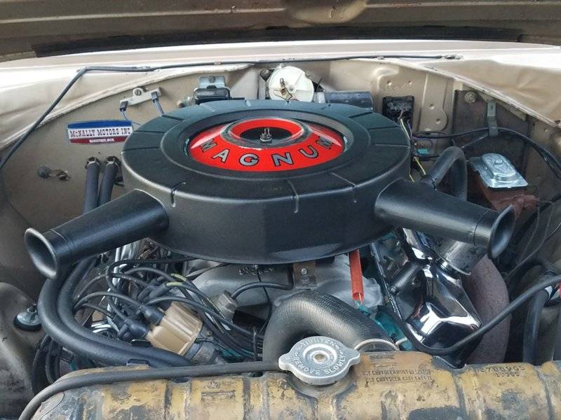

Depends on what type of electronic you are using. My Hemi has a stock original dual point dizzy that is converted to Pertroxyx ignition. Looks bone stock. I got my wires off eBay as the seller had the date codes I needed. And number 7 wire had a rubber extension on it making it pretty easy to get in with the brake booster in the way. Username was Lectralimited.

The reason they say points only is the resistance requirements is different between the 2 ignition systems is slightly different
Now,,,,, That said I ran them on my cars and sold them to numerous customers running the mopar electronic ignition and not once did I have any issues or comebacks.
