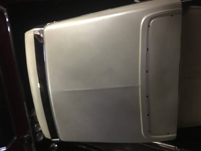

I’m getting around to some interior stuff on the GTX and I’ve done some searching but can’t find any replacement for the piece missing on both bucket seats. It’s on the lower part of the seat back. Thanks in advance.

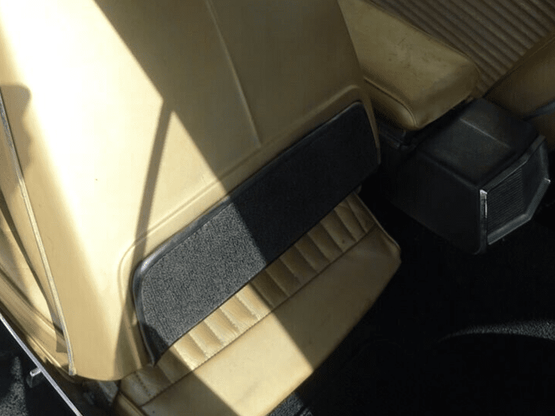

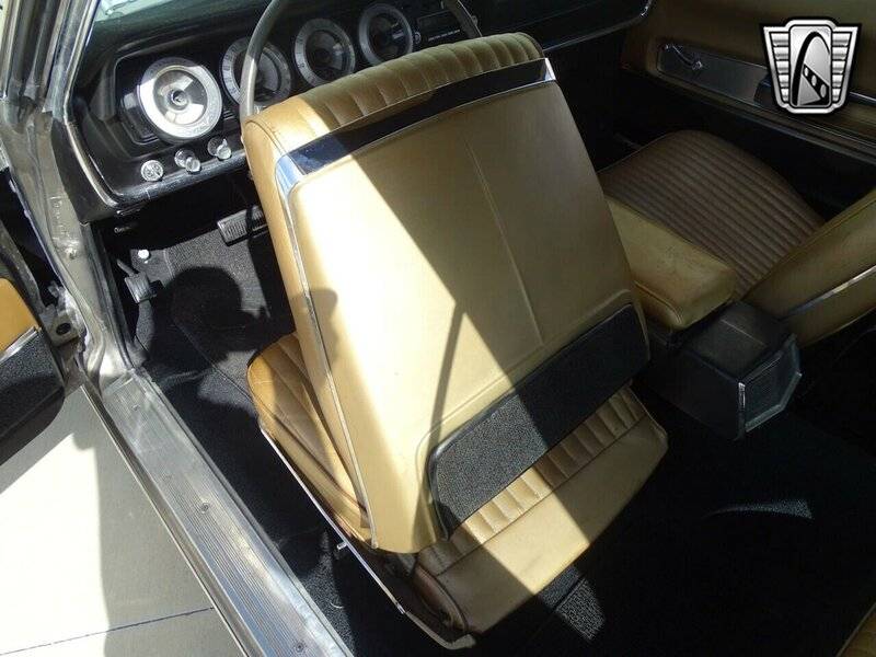

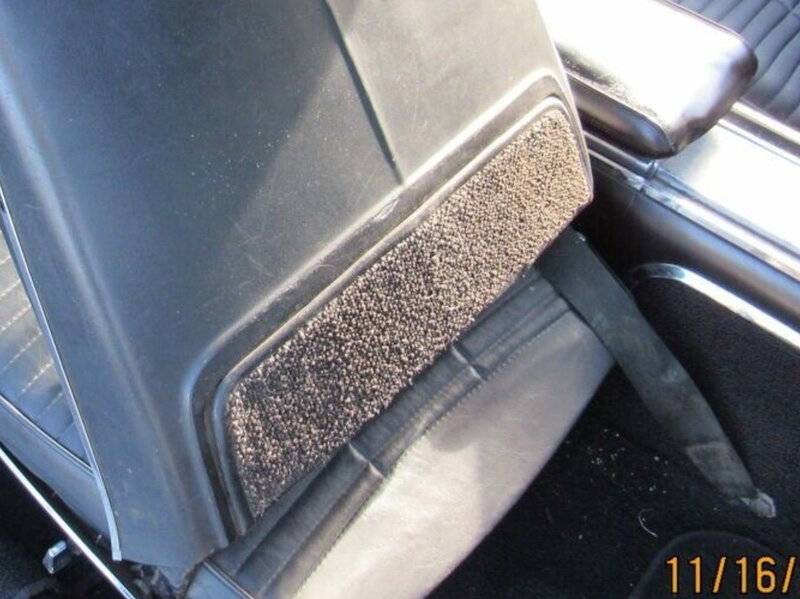

You have a Dodge Charger seat back. They are the only ones that have the carpet piece on them. It is carpet with a vinyl border sewn on it.
Coronets and Plymouth’s were blank with no holes there.
can see it in this photo

So apparently someone through the years replaced the seats in my GTX with Charger seats.
In all likelihood the seat frames, tracks, springs, etc are the same for any given year of B-Body Plymouth or Dodge. Differences probably start at the foam.
