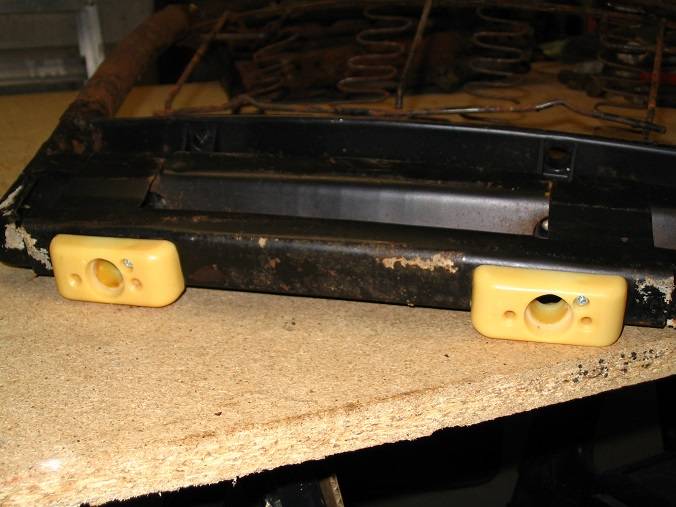

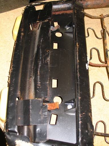

This is a 68 seat back that has the ability to add headrests but did not come equipped from the factory
My 68 Charger has a Dec 67 build date so not the earliest but it did in fact have the holes in the seat backs for the head rests. Also the holes for shoulder harness of which I added both. You do need the hardware so should have what you need.
Perfect thanks Dan for the photographs that is just what I was looking for - that answers my question about the frames. My seats are easy to identify from your photos.

I assume the black plastic guides are held in the seat frame by self tapping screws?
What stops them falling out?
I mean the 8 black guides of 2 different types.
I also have 4 spring plates but I think I know were they go from Dan's photos.
Also figured out the upper white bushes from photos.
