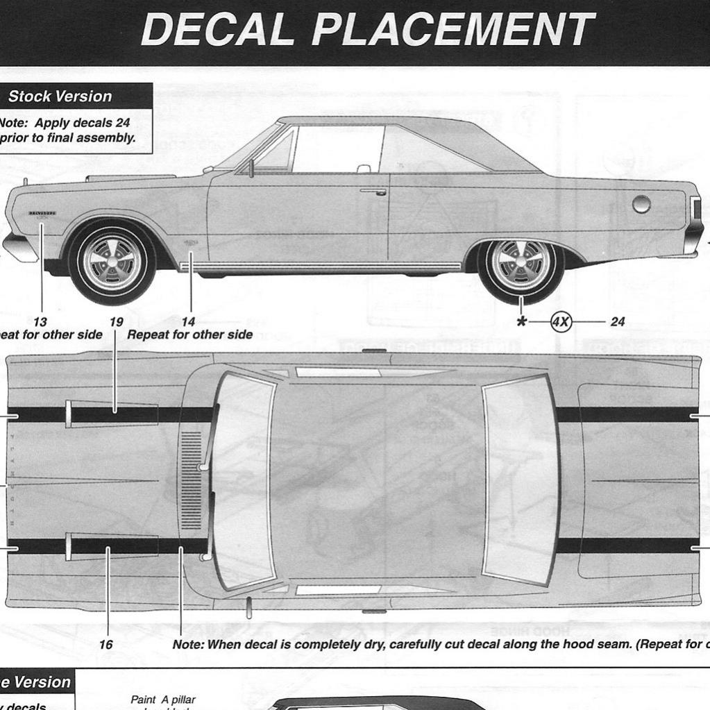

4" inches...... heres a photo of decals

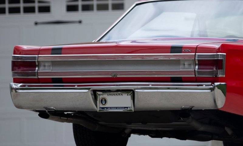

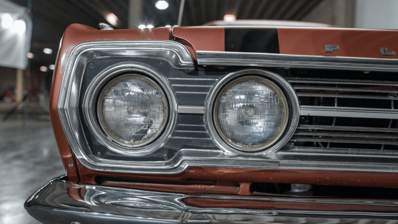

Ten years later but I found the model car instructions image two posts above via google search and the incorrect trunk stripe location in the image bothered me so much that I fixed it by moving the trunk stripes to align with the reverse lights in the image below. Note that the front and rear stripes are not the same distance apart front to rear. Strange but true.

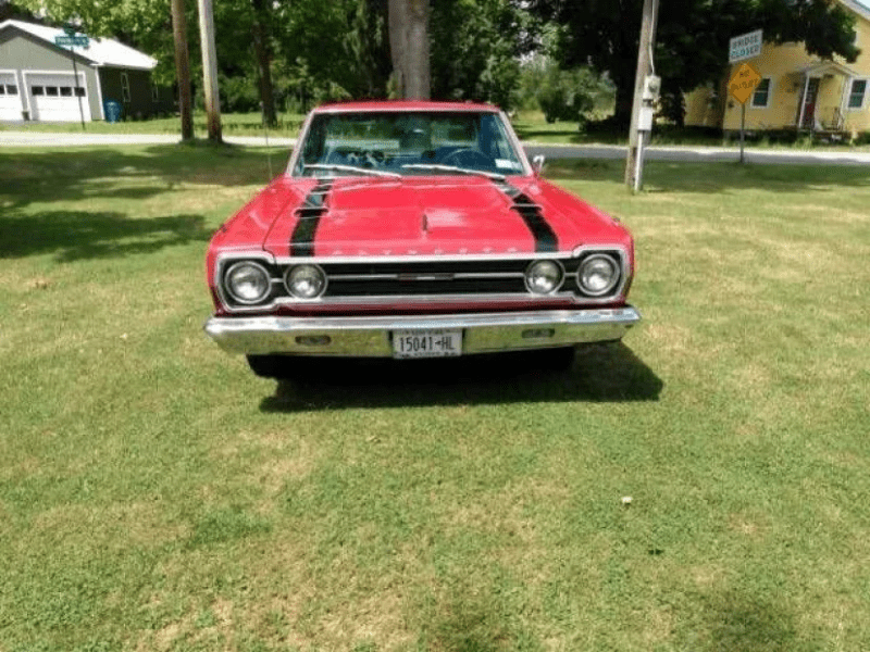

Here's what it comes out looking like (incorrectly) if you follow the uncorrected model instructions and do symmetrical stripes front to rear. This car sold at Auction in 2022.
Note this is INCORRECT.

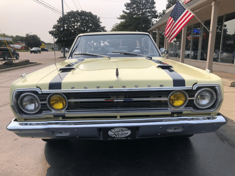

I thought the front's lined up with the inner headlights and the rears lined up with the back up lights.
...but that red car looks good.

The "decal placement" refers to the instructions in the 1:24 scale plastic model car kit, not the real car. If you look at those instructions at the very top of the thread, the model car maker had the stripes in the wrong spot on the rear of the car. I fixed the image to show where they should go.

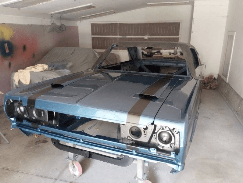

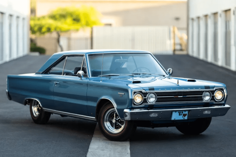

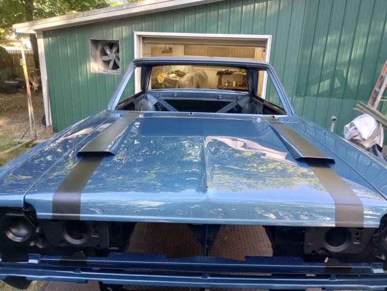

if anyone is interested........ I painted the stripes on; did them flat as requested, but color and gloss is easily changed at any time in a few hours, if the novelty wears off
laying them out with tape was interesting, especially up front......... and it all starts with the hood and the scoops (yes, I lengthened the scoops and made them functional)
the hood has a slight crown from the center out......... the shape of the scoops compensates for the crown to keep the top of the scoops level....... the scoops are actually taller on the outer side
anyway, the stripe is centered in the scoop, and also centered over the inside light........ the stripe has to "turn" to the inside ever so slightly when it comes over the front of the hood....... because the hood is crowned, the stripe does not drop over at 90 degrees off level, it drops over 90 degrees off of the crown
under the light, on the valence; you'd think dropping a plum bob off of the hood stripe would work; but the angle is severe enough that the plum bob mark on the valence was almost 1/4 inch too far outside
