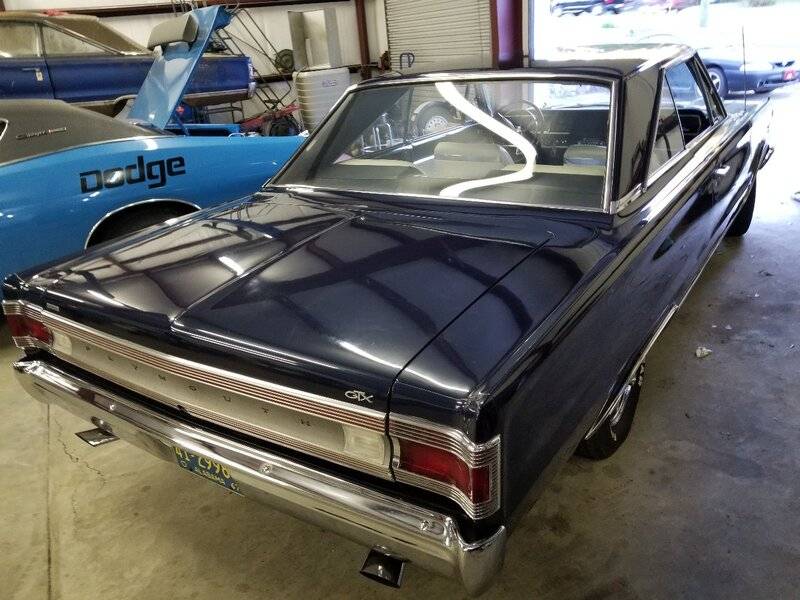

Howdy,
For the life of me, I can't find dimensions online for the location of the trunk emblem holes for a '67 gtx. I seem to find fender locations, but none for the trunk.
Can anyone here help me with some measurements?
Thank you kindly.
I can measure emblem placement, but you will have to figure the holes from that.
Much appreciated Jerry. I can use that.
Beautiful car. Nice deep colour.
The X is 1 1/4" from the trunk edge. The base of the emblem is 3/8" from the tail panel. Measured the same on 2 different cars.
