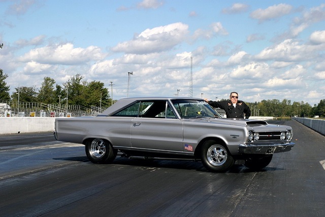

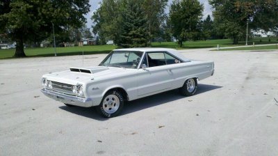

Here's a little inspiration from our '67 Satellite...
