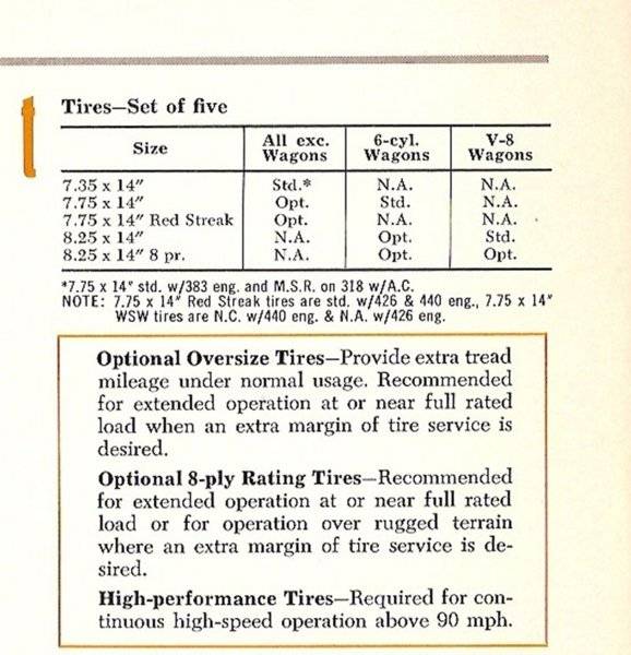

W/W were optional.
Here's a snippet from the data book that may help.
W/W were optional.
That's the part I was missing. I wouldn't view WSW as an 'upgrade' or a better option to red lines but I guess it may have been back then. Safe to assume that's what the car was born with. Thx.
