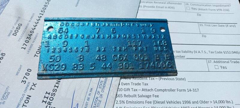

Hello Everyone!
I have a 68 Charger that has a Y9 Special Order fender tag code. It also has a Z8 Hood Performance Paint Treatment. I know Z8 is only supposed to be on GTX and Roadrunner, but here it is on a 68 Charger.
Does anyone know what this Hood Performance Paint Treatment looks like? Is is the same as the V21 option on the 69 Charger? I have attached pics of the fender tag and broadcast sheet.

Thanks for the insights, gentlemen.. I am thinking this is an extremely rare option - perhaps even a unicorn. I could not find a single fender tag with the Z8 code. I also could not find a single 1968 picture with the V21 type hood treatment.

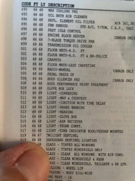

The Z8 fender code is the sales code 508. As seen on the broadcast sheet, 508 is SPL Paint Treatment.

Codes are not always the same across model likes. What 508 meant for a '68 RR/GTX may be something totally different for a Charger. Unless I had supporting documentation, I would NOT presume they means the same thing as another make, model or year. You need to find out what 508 means for a 68 Charger.
699 may or may not be related to 508. Don't make assumptions. Find supporting factory documents. IF it was an additional cost item, it would be listed on something like a window sticker or invoice.
