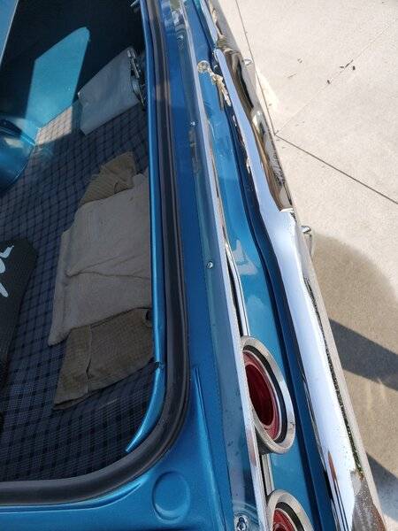

These are the screws that attach the stainless steel trim to the trunk opening lip. Would like to see a pic and dimensions of an original screw.
If anyone has a source for them, that would be great. I've tried R/T Specialties, but they do not show a listing for that particular screw.

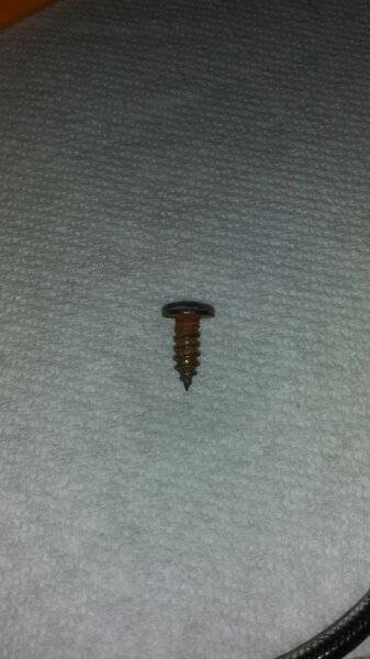

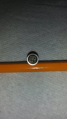

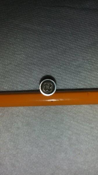

Bob, these were on my car for the last 33 years and probably since new. The head diameter is 5/16", threads are 7/16". Looks to be #6. The top of the panhead has a very small triangle stamping.
