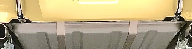

Where does these holes on the rear bumper mount? Anyone else’s look like this?
Looks like your gonna need to do some bending on those tabs. They need to wrap under the rear valance. The bumper on mine is the original animal.

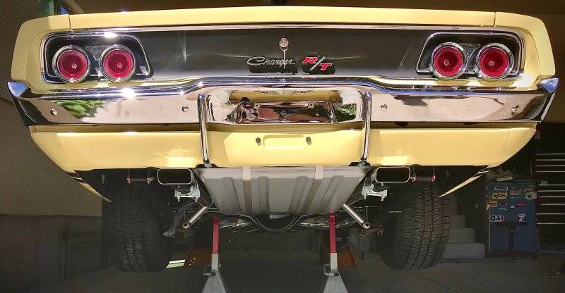

Each side should have a u-nut clip to run a bolt thru. I just installed the bumper a few days ago and this is what it looks like underneath the bumper. My bumper is slightly off center, so I haven't fastened it yet.
Looks like your gonna need to do some bending on those tabs. They need to wrap under the rear valance. The bumper on mine is the original animal.View attachment 1667378
Is there a gap between the valance and guard? Mine is pretty close now, but when I line up the guard hole to the hole in the support it pushes the guard out creating a noticeable gap.
Do none of you have these? The rear bumper on mine bolts through one of these on each side and there is a notch in the rear crossmember to go around them. I’ve read they were an assembly line attachment point, and I’d like to remove them, but they are needed for the lower bumper bracket?
