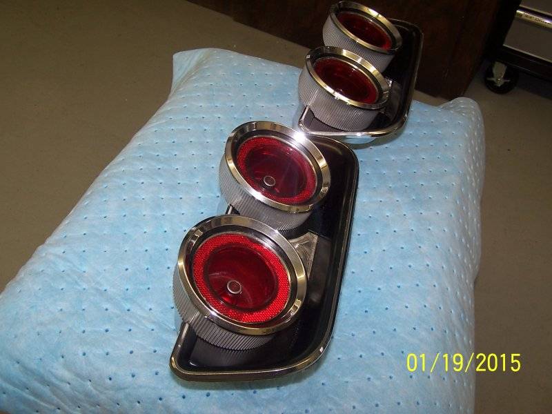

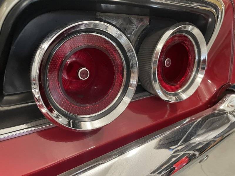

Here are some pictures of my taillights. All original re-chromed. They are not perfect, but they have an all new shine!
Left before and right after:
