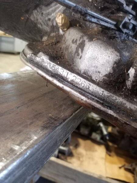

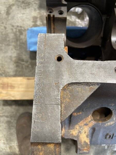

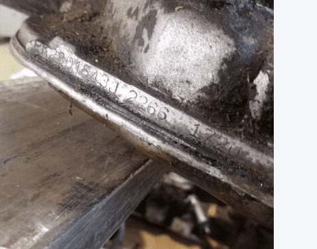

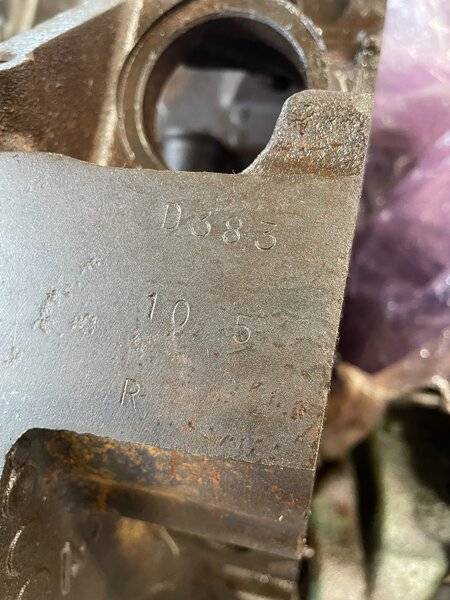

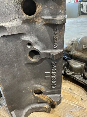

For the serial number stamping, you need to look on the back of the engine, on the rough cast portion of the bellhousing rail. When the trans is bolted to the engine, they stamped the vin on the trans bell rail and the engine in the same place. Not all 68s were like this, but it's worth looking for. My 68 hemi road runner was stamped like this, it looked like the person doing the stamping would stamp the block then the trans, then pick up the next stamp and hit both again. I'd like to know if they did that on yours.
Just run the round part of the back of the block and look closely for stampings, starting above the starter and going all the way around. Good luck.
Nice!! Thank you I’ll post some photos soon

68 non HP motors will not have any stampings on bell house area.

Motor assembled Oct5 67 confirmed by the 2260 on bottom. R means 290 horse. Build date of Car Oct 20. Looks perfect!
Just noticed your comments on the year built as 1967 I’m assuming you meant 1968 as the 2260 indicated

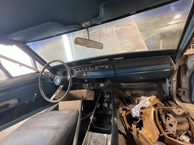

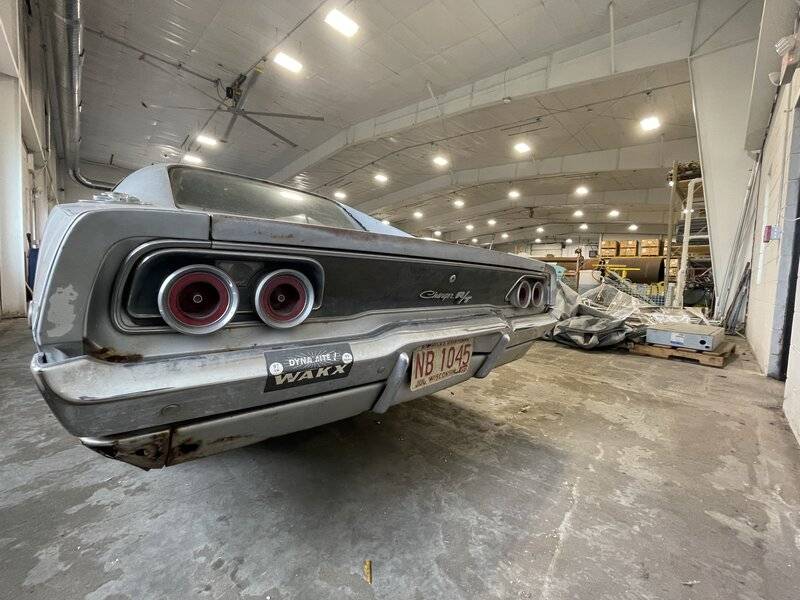

So when I first purchased this Charger the speedo reads 9,387.6 miles. I assumed it was more like 109,387.6 but to be honest that’s impossible the town were I found her, has a 50 year average population of +-20k and covering a few mile radius of industrial marine work and rural farmers.
This charger was originally bought new at the local dealership in that town (I have the Invoice and dealer order ticket)
Looking at the condition of the car itself it seams correct to be driven in snow, ice and street salt for 8 years of registration then parked for 45 years. My question is has anyone come across such a low mileage Charger obviously it has rust and issues and in a million parts So I need some feedback on what to do with this unicorn to be honest I don’t even know where to start or how original do I leave it. I also know it’s my choice but I don’t think many of these are around anymore that’s the problem I see

If the car was a true "survivor" meaning virtually no rust, and in complete original condition then I might think your should be concerned about preserving it. But the fact that you will need to do some rust repairs, and a little repainting, and the fact that you will have to re-assemble the car to get it back on the road I don't think you should be too concerned about it being a low mileage car.
Clean it up as best you can, try and maintain as much originality as possible but don't compromise on safety and your ability to enjoy the car simply because of it's low mileage.

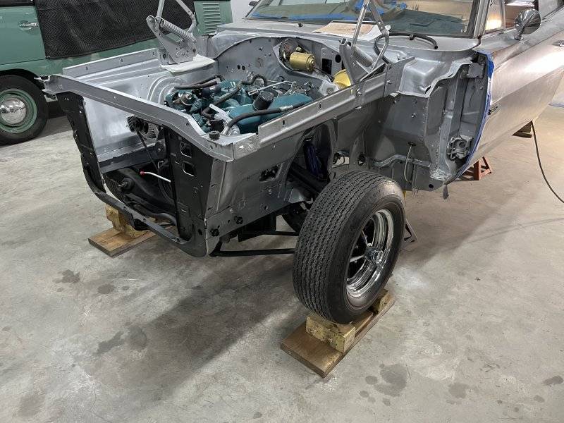

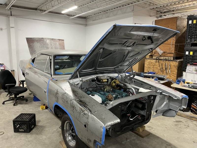

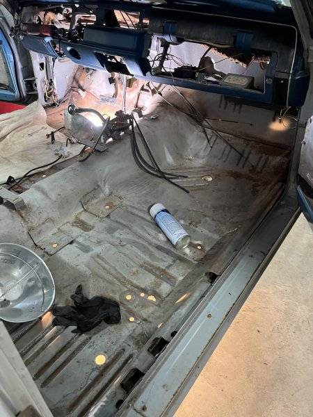

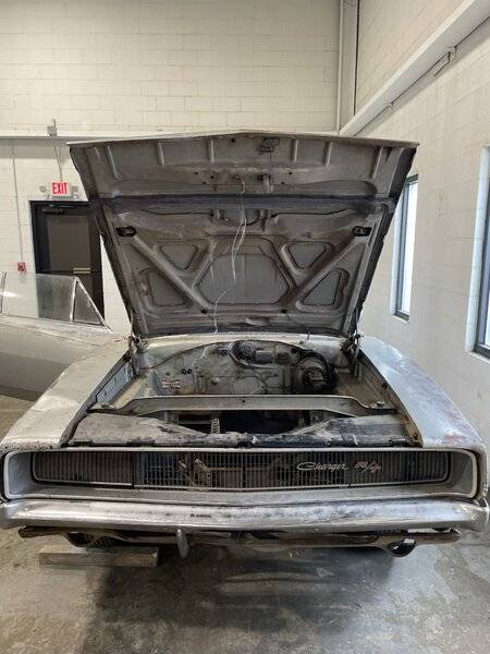

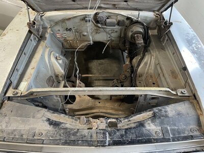

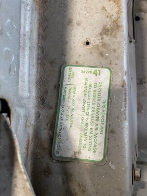

A quick update on my progress I’ve gone through and tore out everything that needs attention on the charger. Decided to restore all but the outside, other than repair minor rust on rear fenders and a few spots on the drivers side floor. haven’t done any welding yet. The front end was in perfect condition, zoom in on the fire wall i kept the #5 magic marker not sure what it means maybe someone can tell me. Thanks for looking!!

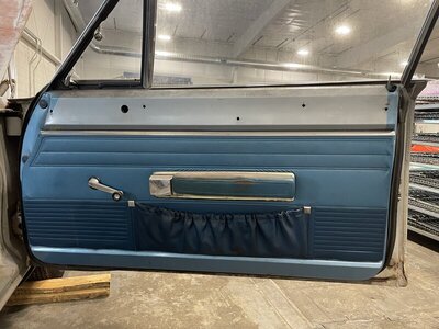

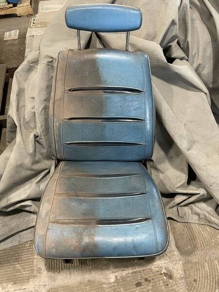

Great looking car that you have. The condition of the seats is amazing. I can't wait to see it cleaned up and back on the road.

The suvivor cars can be just as much work as a nut and bolt restoration. Love your car, good luck!
