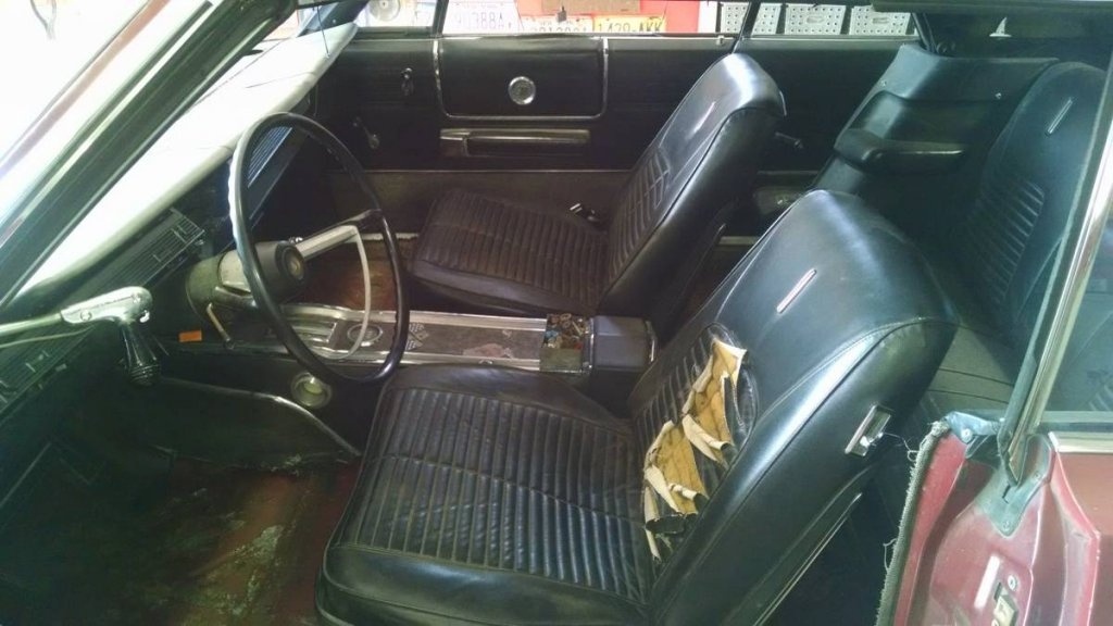

anyone know if the bucket frames for the 68' Chrysler 300 are the same as all b bodies
this is what they look like ..the side release is different than any I've seen

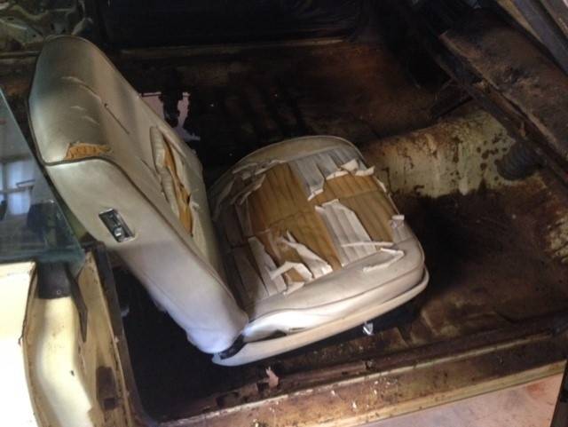

In a week or two or five, I'll be pulling some '68 300 Buckets. I don't plan on stripping them down to the frames, and I don't have any other low backs to compare them to, but I have a '70 Charger floorpan out of the car I can test fit them on. I'll post back with the results.

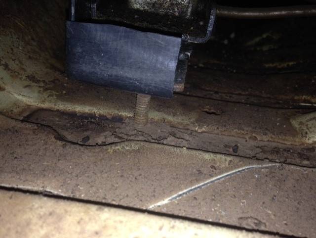

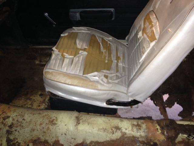

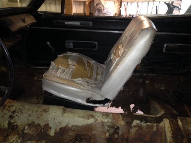

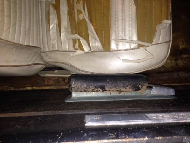

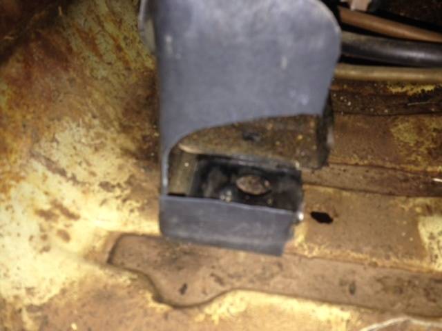

Here's pics of a '68 Chrysler 300 seat in a 1968 Coronet. The tracks are about 1" wider. The fore/aft measurement is the same. It looks like they'll fit fine by drilling the outboard holes 1" further. As far as the frames being similar, I don't know.
