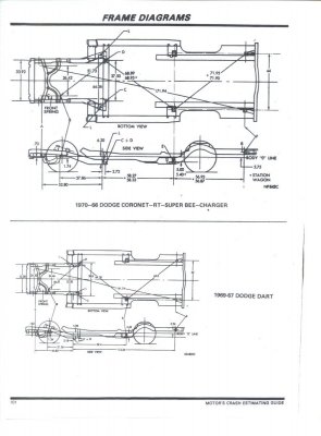

would anyone have front frame measurements for a 1968 dodge coronet. I have my car at a shop and he needs measurements so he can put front frame rails true. Thanks, rustymetal
Here they are.
Would these dimensions be the same for all B-Bodies? Mine is a 1962 Plymouth Sport Fury. I am interested in the rear spring mount centerline measurements. My car had the front hangers welded in conjunction with frame boxing/ stiffening, and I would like to install super stock or other six-leaf springs. I understand the front hanger centerline must be changed when you put SS springs on a B-Body. I need dimensions so I can cut and re-weld my front hangers for the SS springs.
