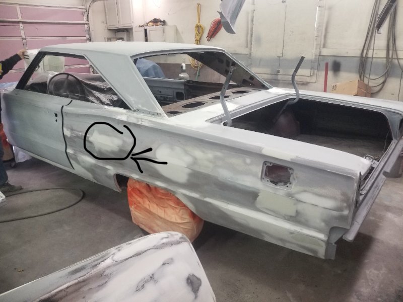

Looking for a diagram or measurements to install both R/T emblems back on my 67 coronet qrtr panels. Both qrtr panels were repaired. Need to put back the holes... Only want to drill once! Thanks.

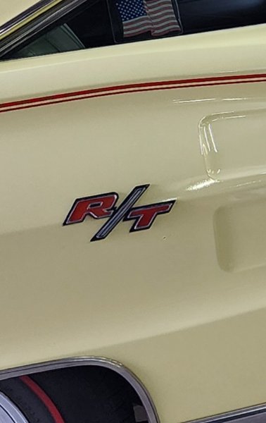

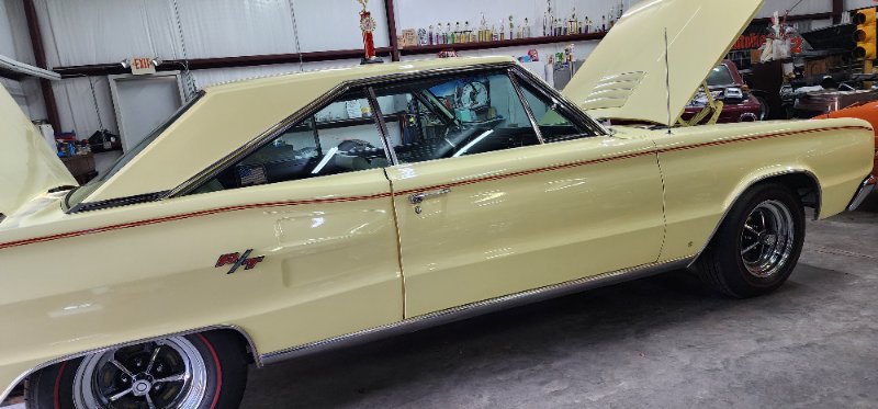

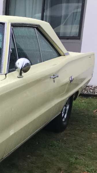

Here is an old picture I took a of 67 r/t at a show though, and to me here it looks like it goes on the front edge of the c-pillar almost in the middle of wheel well….

I can get you measurements for the holes in the next couple of days if no one else does. Looks like the most accurate would be from the edge of the coke bottle indents horizontally to the holes and from the body line that runs through the middle of the emblem vertically to the holes.

I just measured mine. If you project a line (I used masking tape) joining the rear edges of the 2 scallops, the forward edge of the R/T sign is exactly 2" behind that line. The contour of the sign lays over the rear fender crease, as shown in Jerry's picture.
I would have posted a picture of mine, but it pretty much looks like Jerry's.
