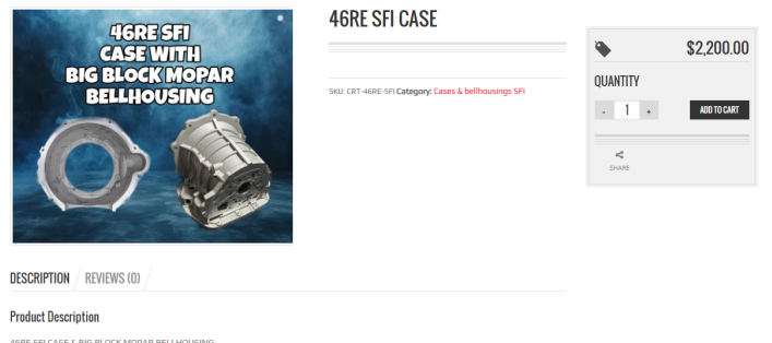

I plan on a 46rh swap in my Coronet if you grind a rib or two off the O/D housing no floor pan mods. I seen Cope makes a bb case now. I wouldn’t have a problem with the ultra bell either.
I plan on a 46rh swap in my Coronet . I seen Cope makes a bb case now. I wouldn’t have a problem with the ultra bell either.
I saw that the Ultra Bell is listed for $900 but had to dig to find this:
Just add it up. $2200 for the case, maybe $1000 for the converter, you need a functional overdrive unit to hang on it plus all the guts for the main case. By the time you're done, you're barely under the cost of a 4L60E/700R4 and you're still stuck with a 2.45 first gear.
