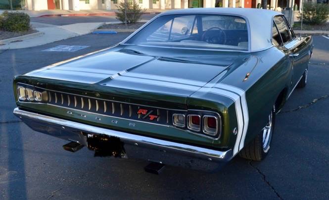

Nice looking '68. Is that the original color?
Yes, but it was repainted at some point the original GG1 for the year.
Almost like mine in LL1.

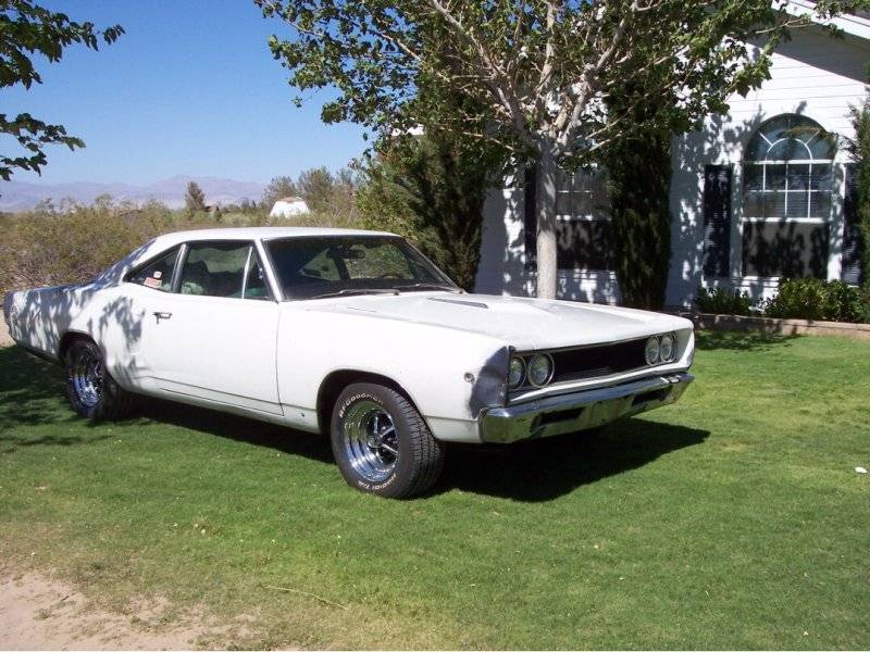

I have off-the-shelf 8”x15 Wheel Vintiques magnums all the way around on my 68 bee. 275’s rear, 245’s front. No rubs
I have 8”x15 Wheel Vintique magnums all the way around on my 68 bee. 275’s rear, 245’s front. No rubs
Nice. Any rubbing anywhere? Were you able to run them at a normal tire pressure, or did you have to reduce it to below 26 lbs like some have been saying on here? What gears do you have? I am looking to switch over to 3.91s in spring.
Guy
Normal pressure, 3.73’s, no rubs. 440 HD rear springs from MP. 60 series radial T/A’s

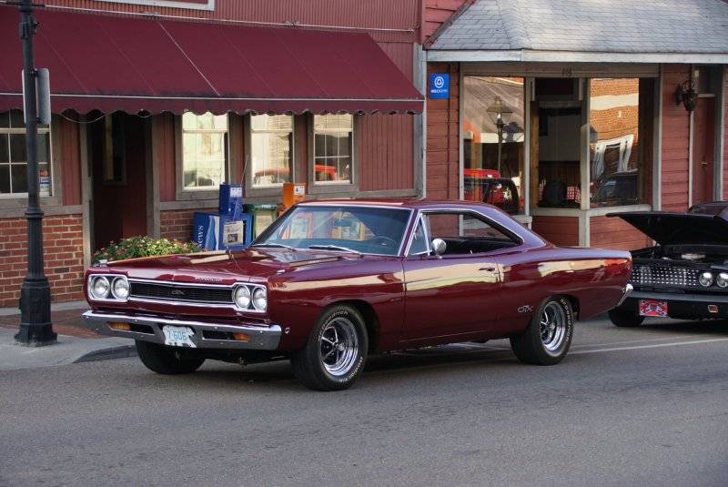

275/60/15 on 15x8 Magnums on the rear of Fred right now in fact.
"Normal" as can be...
