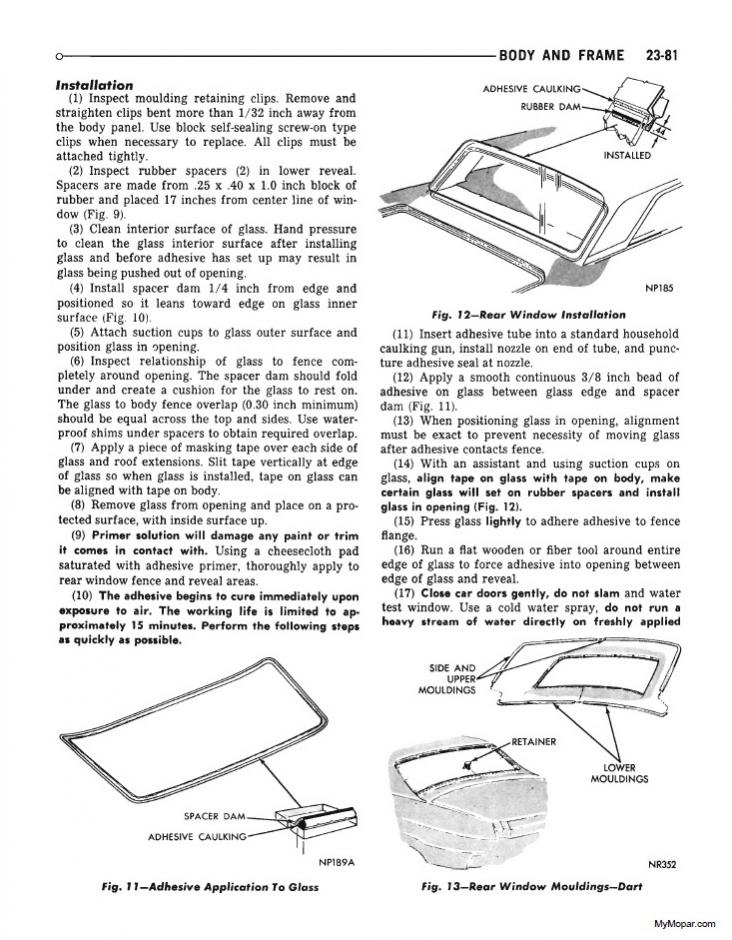

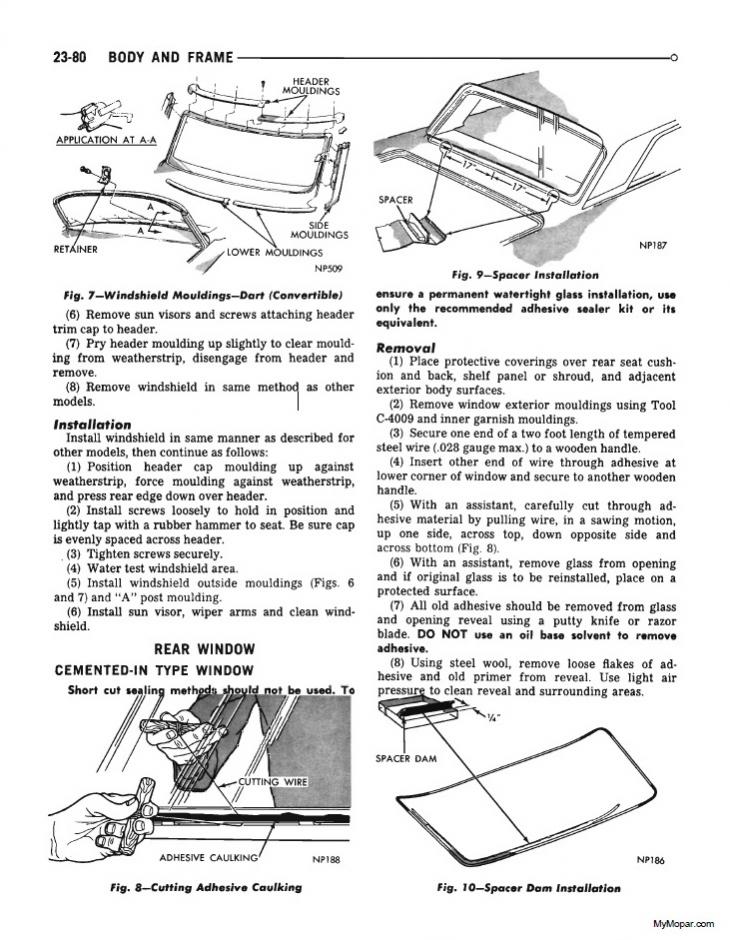

Anyone know where I can buy one? I have looked at several places and none of them have a rear windows seal for a 1968 B-B Body Dodge. Is there not a seal, do you just use sealant or something? Any feedback would be great.
The back does not use a gasket. Here you go
http://www.ebay.com/itm/Windshield-...Parts_Accessories&hash=item3a85f487ea&vxp=mtr
Also available at a glass company or most auto body supply stores
And don't forget to save, clean, and reuse the rubber blocks (spacer dams) that the window sits on.
Thanks for the information, I was thinking that was it and my brother who is doing the body work was almost positive, but asked me to check into it just in case.
Thanks FBBO.
