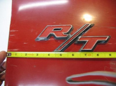

I am restoring a 1968 coronet RT and some time in its hard life it has had both front fenders replaced with the wrong ones and they never reinstalled the RT fender emblems on it.I guess whats the piont if you put the wrong fenders on it anyway. LOL. Can anyone tell me where I might be able to find measuements for the proper placement for the fender emblems or maybe someone out here has an RT that they are working on that can take some correct measurements for me. The emblems have 2 pins on the back and I want make sure I put them back in the correct location. Thanks, rustymetal
I think I can get some dimensions off mine tomorrow. If you don't see me post something here you can pm me as a reminder.

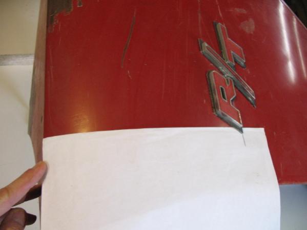

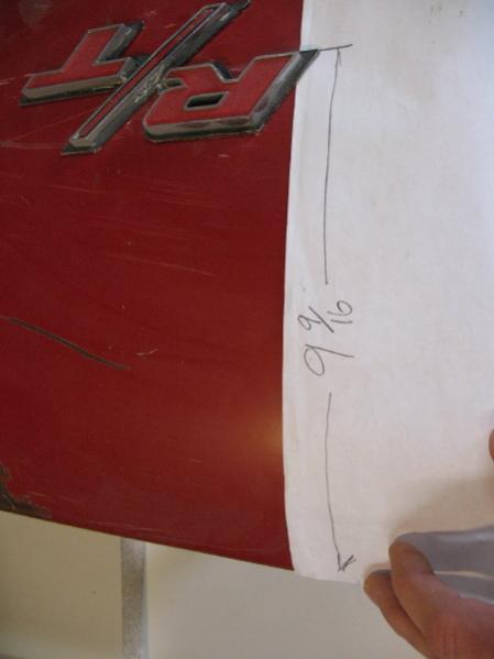

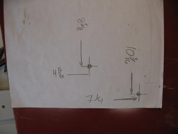

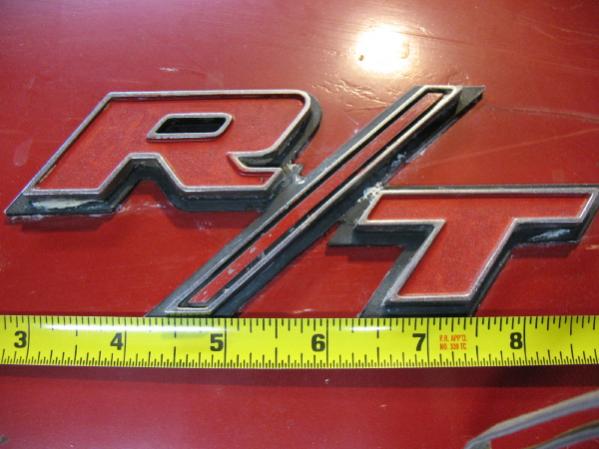

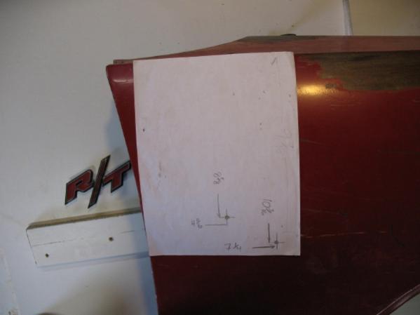

I decided to post these up here first to see if someone can verify the dimensions. Alot can happen in 43 years, but I'm pretty sure that this fender is original to the car.

Hey thanks alot, you are awsome. These measurements are great. Thanks again, rustymetal
What's the size of the holes , drill bit size ?
