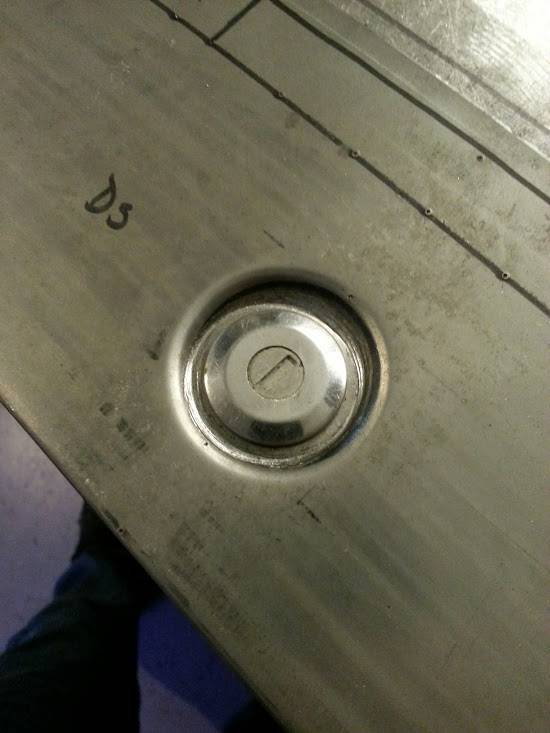

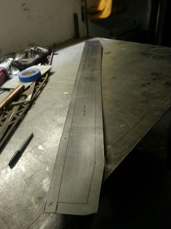

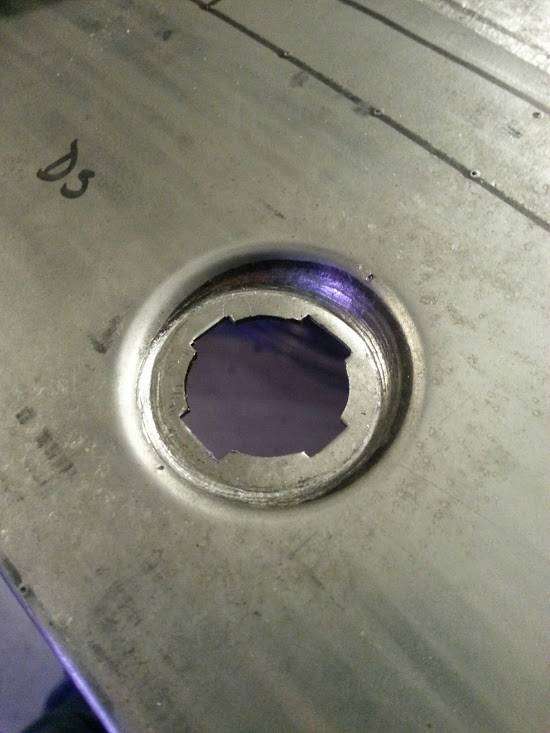

Morning. Figured Id pop in to answer your question.
The entire bottom section (the face the keyhole is on) actually has curvature to it. It is concave across the entire width of the lid. When I recently did this repair panel, I rolled it through the English wheel just a bit to create the curvature needed.
The issue is, that because the deck lid has a peak in the center, you cant just form that curve over the edge of your table for the entire width of the panel. You need to know your center line, and form the curvature from the outer edge, to the center line of the panel. Separately... for each side.
Hope these images help. :)

Did you drill little holes where you put the fold lines? What are those marks?
Those are punch marks from transferring my paper pattern to the sheet metal. They are my map so to speak. (small enough to fill with sanding primer or filler if need be)

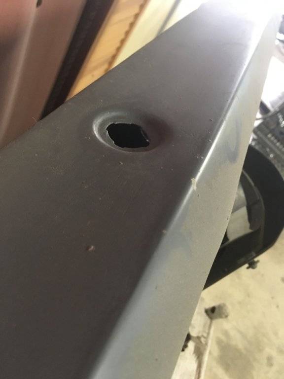

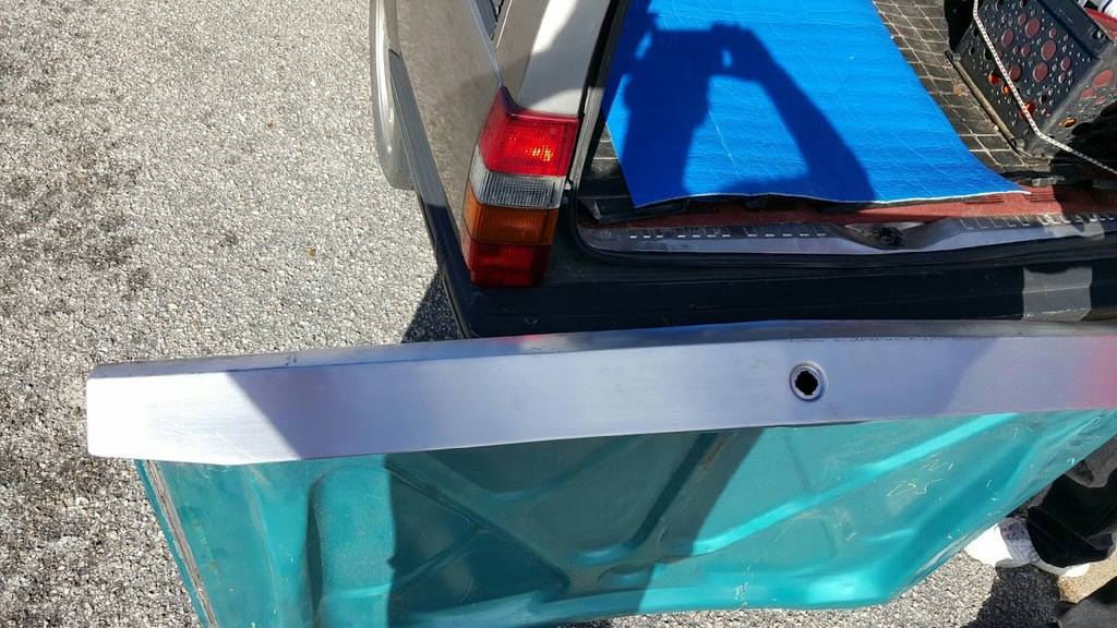

It's curved slightly like the rest of the lip. I had to repair mine as well. Sorry for the dust and dirt. It's been sitting in the corner waiting for the body to get done. If you need anymore specific let me know.
