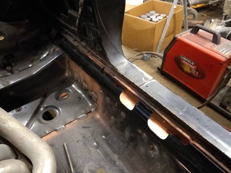

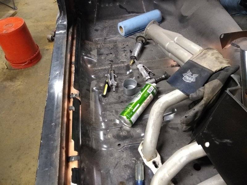

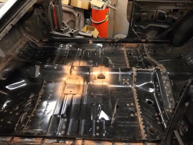

I only have a couple pictures of the AMD covers that I installed on my '68.

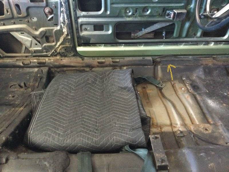

Welded only on one side, see arrow. You can “hinge” the cover up. This view is looking at drivers door area.
You can see the wires running to the tail lights.

Layout your two pieces so the gap falls in the area to the left of the arrow in my picture.

The tabs face towards the door, so the cover opens and pivots towards the trans tunnel. Yes, the tabs are spot welded and then it hinges from the bend in the tab so you have to be careful how many times you open and close them. When I installed mine I looked at as many original cars that were stripped down and it seemed like the consensus is that the short one goes up front and the long one towards the rear. I'm assuming it's that way because if it were the opposite way the split would be right where someone would step while climbing into the back seat which could compress the edge of one of the covers into the wires. Just my opinion of course.
