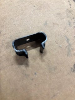

One more question regarding my AMD full floor pan.
It came with this clip that is attached with a screw but I have no idea where it should go. It’s a double clip so I’m thinking fuel line/vent line?
Anyways, if someone can help me out with where this clip goes with a photo I would greatly appreciate it!
