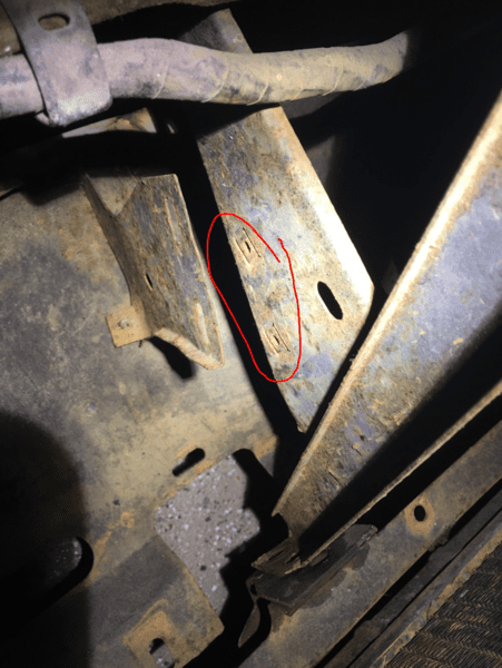

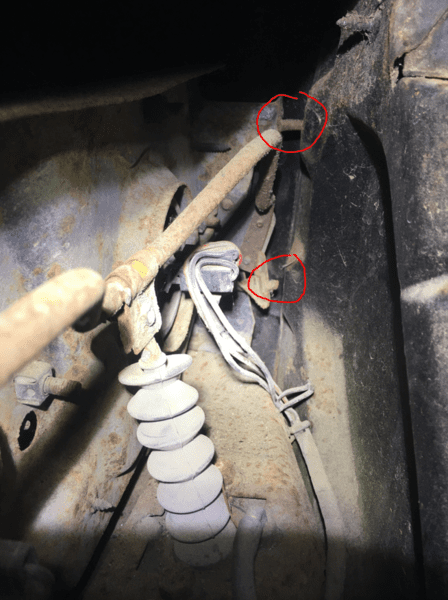

I need help finding the correct screw/nut size for my 68 charger grill and support. I have attached images below of where I am missing the screws. I need complete screw sizes. Image #1 is by the lower part of the radiator and #2 is the nut for headlight bucket to fender.

The bolts that hold the valance tab to the grill support are 1/4-20 body bolts...most likely a 3/4" length...
The nuts that hold the grill support tabs to the fender are I believe 5/16" nuts with a large captured washer...the same nuts used at the bottom of the fenders at the rockers
All the hardware to attach the grill frame to the body is 1/4-20
All the smaller hardware is 10-24 machine thread
