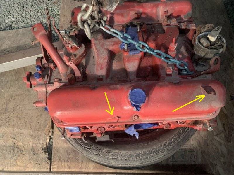

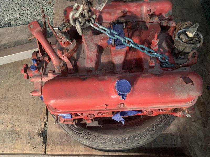

318 Engine: Several items are broke off on my valve covers. Where can I purchase ones like the originals?

318 Engine: Several items are broke off on my valve covers. Where can I purchase ones like the originals? [[[Would help to see what you are talking about.]]]]]

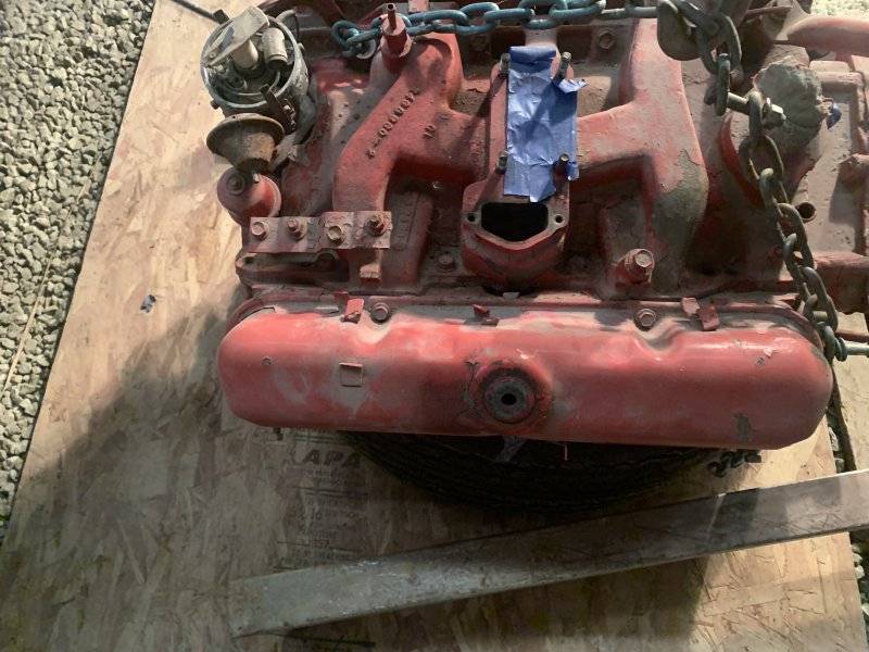

I do not see anything broken off. You are missing all the plastic plug wire separators. Nice all red rebuild.
Difficult to see in the photos, but the metal tabs that the plastic separators hook on to is rusted away and broke off completely in two areas.
Then you will have to fabricate and weld them as needed or find another set of covers which would be easy.
Is this the metal tabs, in the photo from MEGA Parts, that are welded on top of the valve covers? Does a plastic holder for the wire fit on top of the metal tabs?
The ones I sent you is for the alternator power wires and such. U can look at mega and they may carry what you’re looking for.
