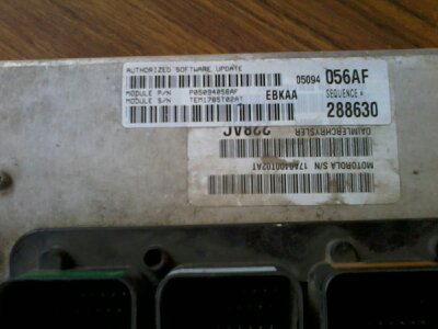

I WANT A NEW HEMI IN MY CORONET SO I WENY TO A LOCAL WRECK YARD AND BUY A 2005 RAM PCM
