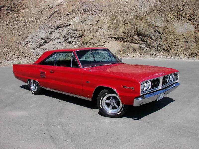

I want to put the fender emblems "Coronet 500" back on my on my '66 2-dr. hdtp. Only problem is that neither fender has the mounting holes so I am trying to figure out the best way to measure before I start drilling holes in the fenders and screwing this up. Thanks

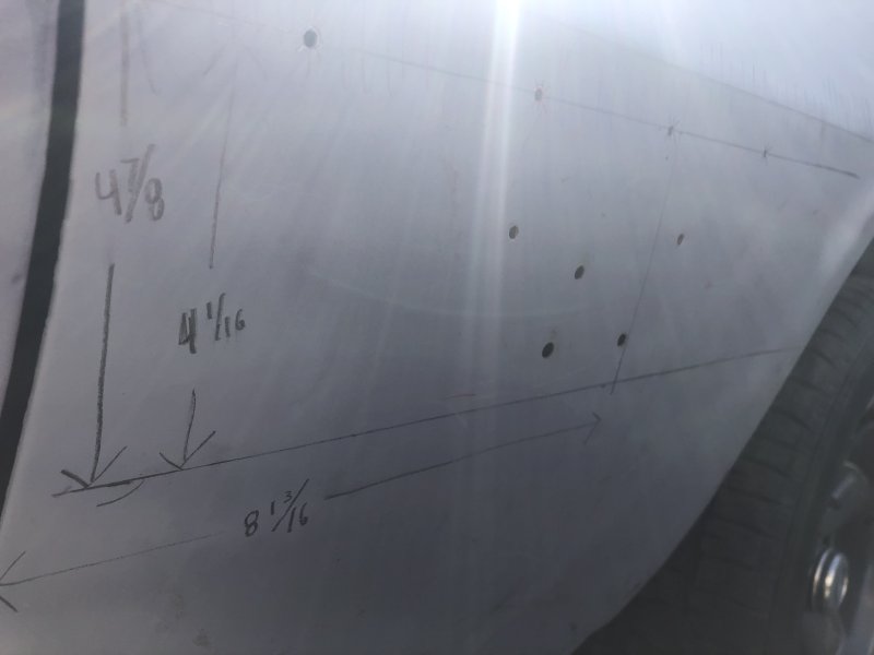

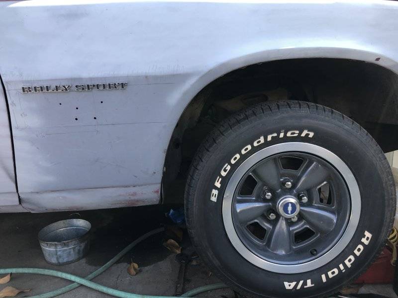

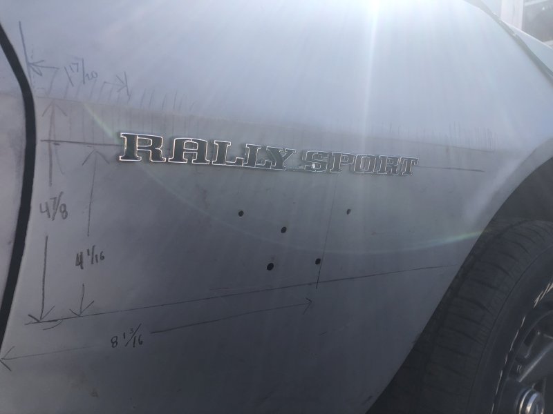

I did this on my 70 Camaro Rally Sport. The used fenders I got didnt have the holes for the Rally Sport emblem. I found a page out of a factory assembly manual with the measurements on it. I transferred the measurements to the fender and drilled the holes.

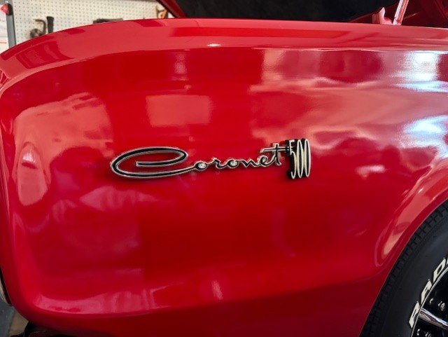

Hi Everyone,
well, I did it. my right fender had the emblem holes filled so i crawled up in there and was able to find the filled holes and drill them out. The left side fender was off a 440 back in '90 so I measured and remeasured about 42 times Saturday morning and then drilled the holes. It looks pretty good. Finding the "500" was a project it itself. Found them at Carlisle back in July and couldn't believe it. Pays to go the first day right when they open!!
