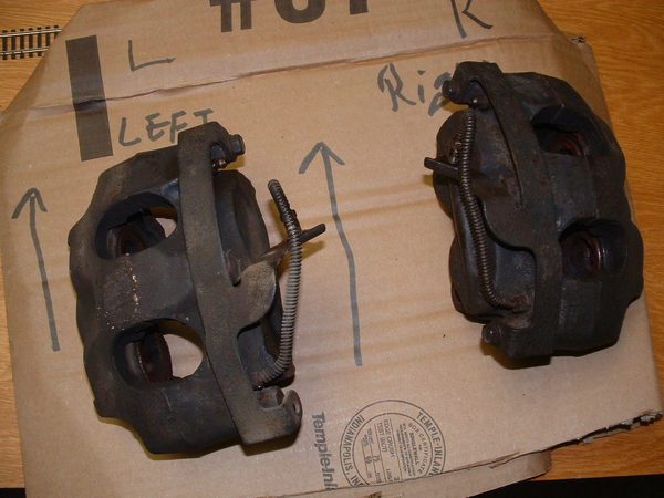

Do you have a 4 piston cast iron caliper or a single piston? Pictured here is the factory Bendix calipers.
Oh, and the original rotors for those are of a two piece design and are about 10.7" in diameter.
