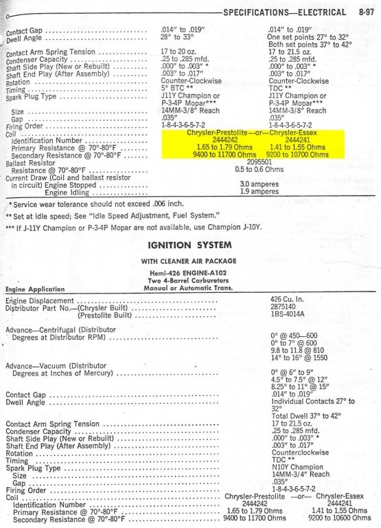

No diff as far as I know.

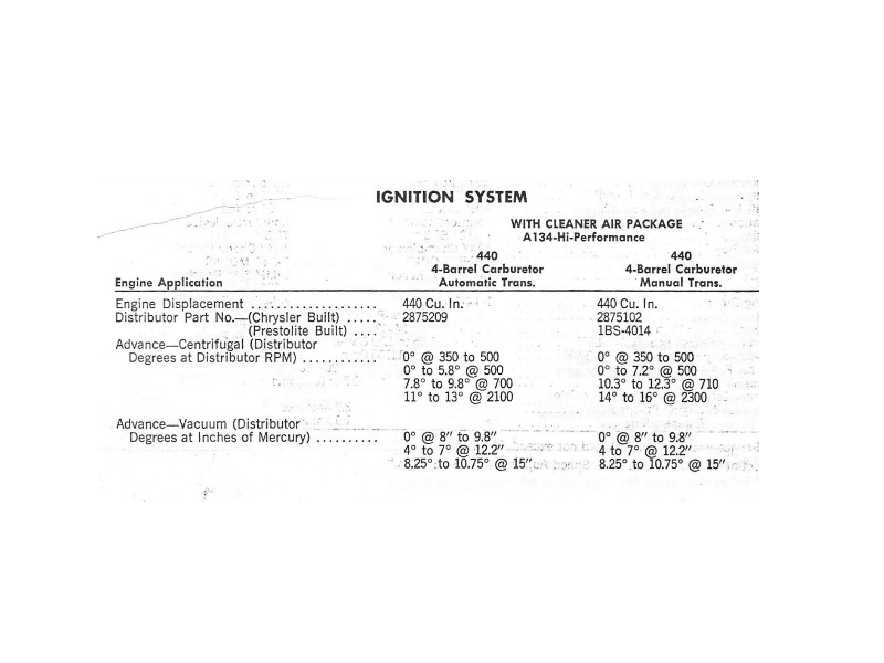

Here are a couple of clips from my service manuals that might be of some help to you. Cheers.
