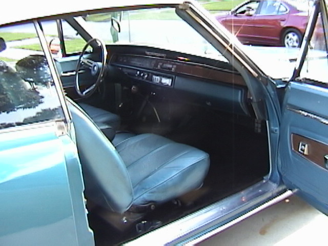

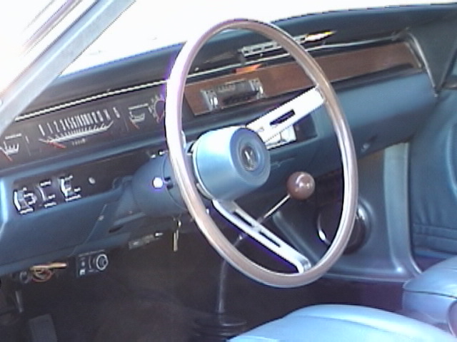

Hi, I am in the process of looking for color matches for my GTX. I know the exterior car color but need more info on the interior colors. There are two interior colors, the dash is a darker blue and the door panels are a lighter blue. Goes anyone know where I go to look up paint codes for this car. I'll attach a few pictures.

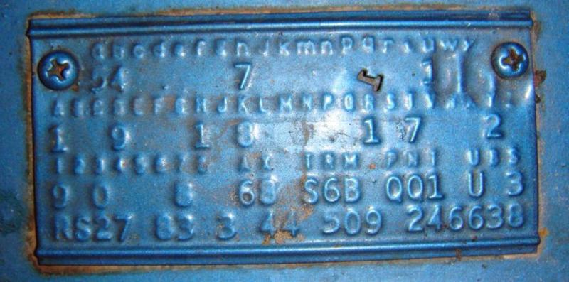

Oh Yeah Baby! I've got one of those! '68 GTX Electric Blue. Here's your Dash color:P8240311.jpg
O.K., you'll see the 2nd line from the bottom all the way to the right, UBS.The "U" is for the upper interrior door color.
The "B" is for buffed paint. And the "S" is for the is for the stripe or accent color. Frost Blue Code "U".
Ditzler PPG 13445. Good Luck!
