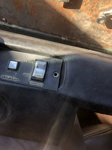

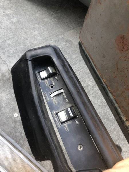

Thank you. I did see a different pad from for ac and non ac. It is also possible I have a pad out of a charger or something else. Here is a pic of my fitment issue

The ac an non ac pads are different, I just meant in the switch panel area they are the same. Really the only difference between them is a hole for the center ac vents.
Chargers came with rally gauges (68-70, the only years for the sweep cluster like you have) and rally and sweep dashes really don’t mix. That pad was out of a Belvedere (rr/gtx/satty/sport satty) or a coronet. All of them are the same.
From the pictures, the pad looks a little saggy, the studs through the dash keep it in place pretty decent. The square edges of the panel sit behind the round edges of the pad. You should be alright when it all gets put on a dash
I will try putting it on the dash first and then inserting the switch panel.
That's definitely not a 68 pad, looks like a 69 non A/C version. In 68 all pads had the A/C center vent area open and had a blank off plate on non A/C cars. In 69 they had non A/C pads like you show, no center vent opening. I would not put that pad on a 68 non A/C car. Sell it and get the right one. That's my 0.02$
SoCal is correct. That is a 69 non-a/c pad. It would use a switch panel that has rounded corners on the right side like the way the left is made
