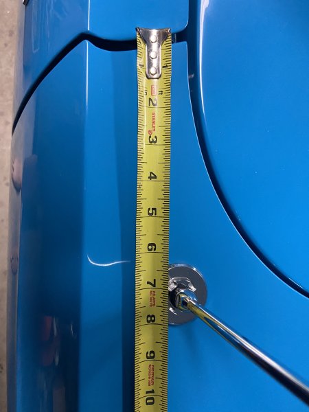

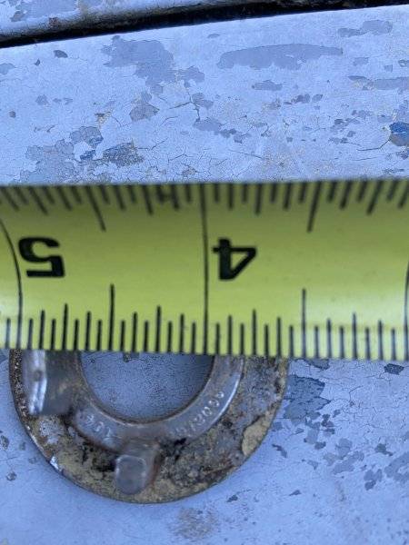

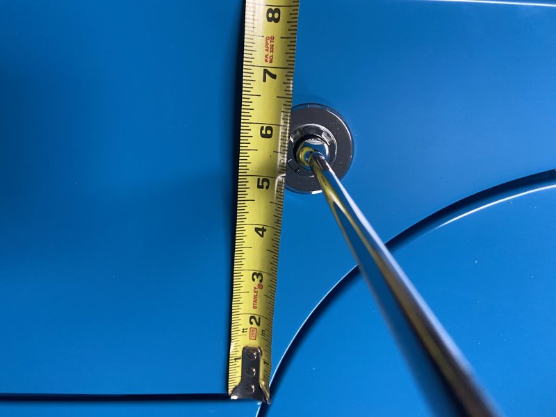

Would anyone by chance have the dimensions for a radio antenna hole for the right fender? A picture would help me also. Thanks a bunch!!
Here you go
If you have your antenna mast, you can go by that. I can get the hole size tomorrow off of a spare fender if you need it. Someone will chime in with the size. A lot of members here have projects in the stage you’re in.
