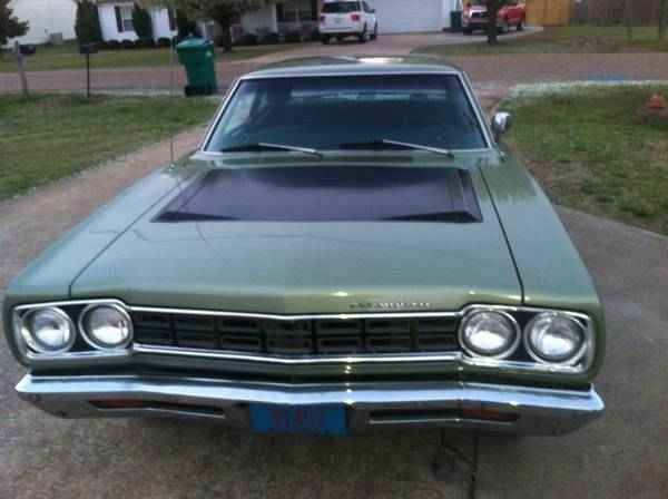

Hi everyone, I recently bought a 1968 roadrunner. Everything was running pretty smooth until today. I went to start the car and it ran for 10 seconds before cutting off. Tried again and nothing happened. So I popped the hood and found one of the distributor wires was out. How? I have no clue. So I put the wire back in and all it does now is make a clicking noise when I turn the key. All of the lights and radio work so I don't think it's the battery. Any help would be greatly appreciated.
