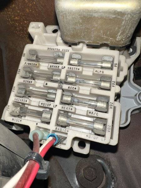

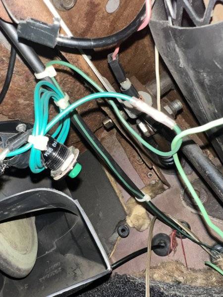

Through some pics up in case it’s something obvious. One this is the guy before me wired in an aftermarket radio quite haphazardly.
There's some funky looking stuff going on there. Looks to me like someone has spliced into the ignition circuit for an accessory.
Is the starter relay on the firewall clicking/engaging when you turn the key to START?
What's up with that green pushbutton?

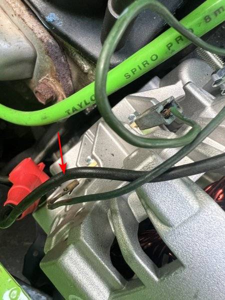

Check this black wire coming from the alternator to see that it's not grounding out somewhere.

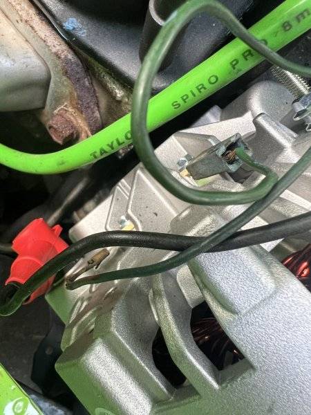

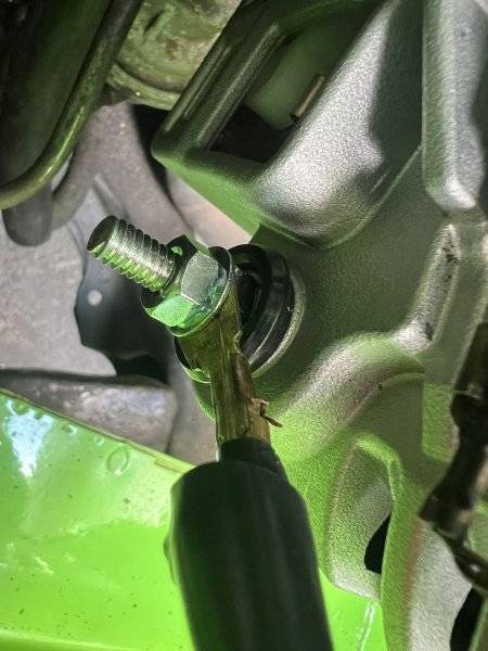

So that wire was frayed and I had to put a new connector on it. I thought maybe that was my original problem. From the pictures below is there a chance I installed it wrong? It seemed pretty straightforward.
I had never noticed that green button before. I’m not sure what it does. Looks like it runs through the firewall near the brake pedal…does it look like speaker wire? I don’t see it coming out in the engine bay.
I know this funky wiring isn’t helping my case but it did run quite well for the past year. Though I’m sure all it takes is something coming loose.
The connection looks okay for now.
That wire could be frayed in other places and grounding out when it runs on top of the cylinder head.
Are you sure you're connect to the correct terminal on the alt? Your picture shows a similar connection on the other side of the alt.
Maybe just the picture but I would flip the wire over 180 degrees. It looks awfully close to the case. You do not want it touching EVER.

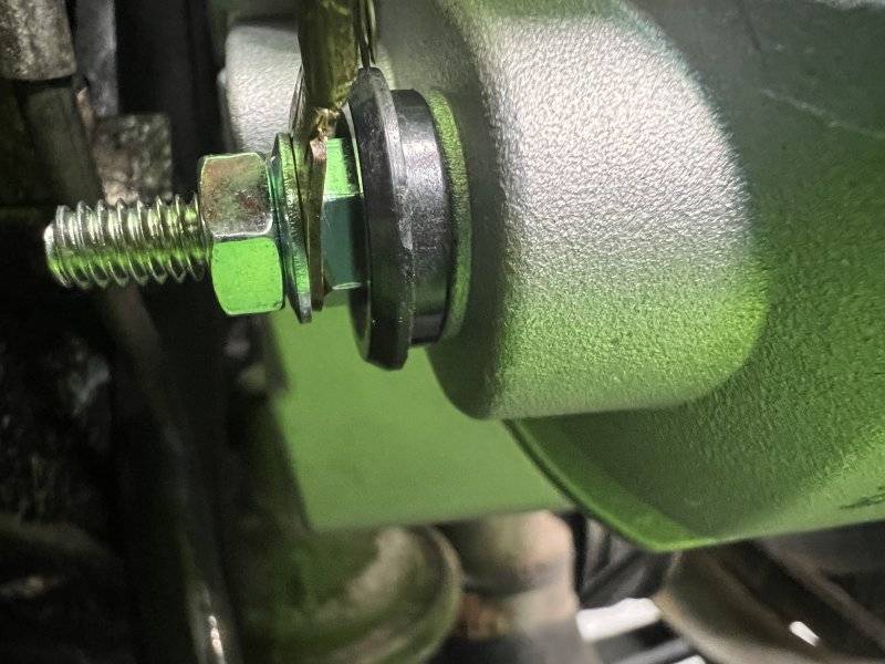

So one I took some pictures of the original alternator so I would make sure and then labeled each wire with painters tape. I unfortunately have made that mistake one too many times. I’m fairly certain they are in the right spots.
This alternator does have an additional stud where the original only had one. But everything else on the casting was identical. The 440 is out of a 75 motorhome but according to Rockauto the alternator I got was good for basically every 440.
