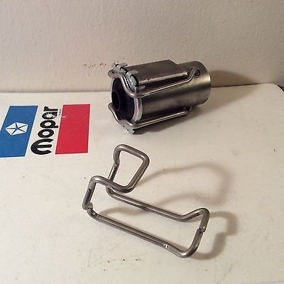

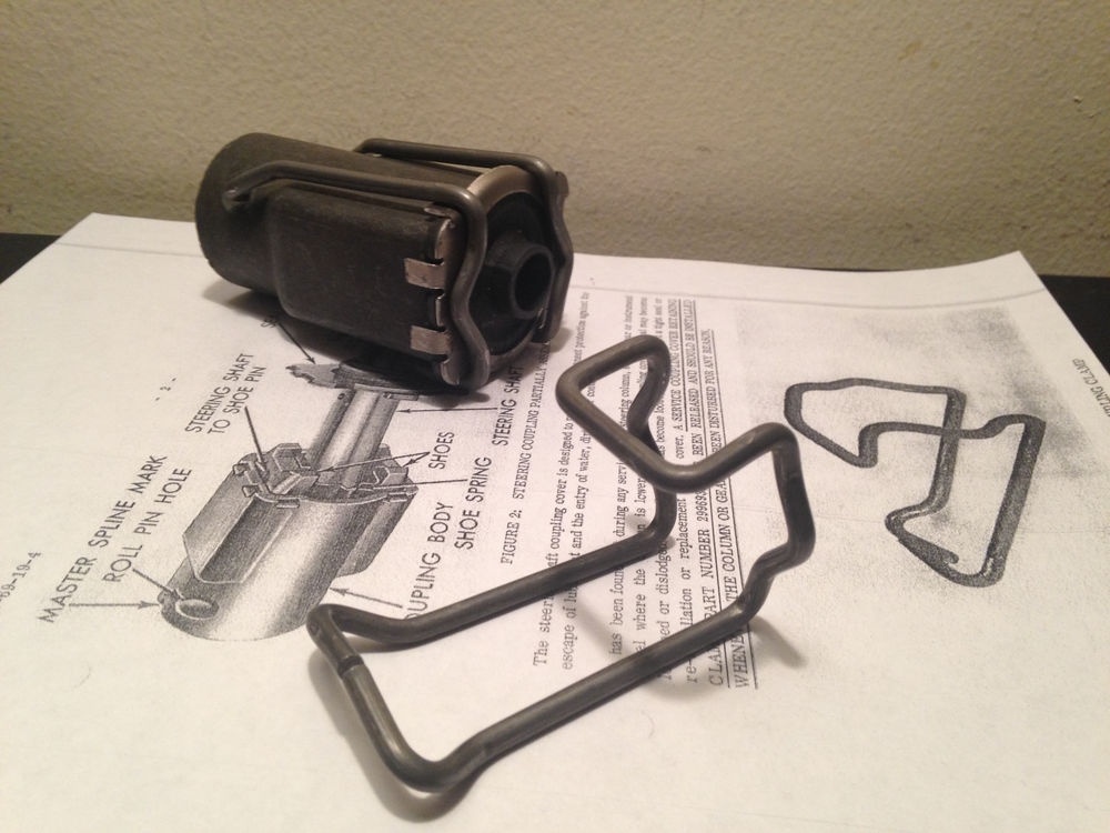

Do those have a retention spring? Doesn't the t shaft and shoes prevent it from coming apart? Mines a 67 so I'm not sure about a 68....
Doesn't have that clip, might make one for it if I can't find one
Got it back together. Ended up making a similar clip to the one you have Mike. Built it out of 6011 welding rods, should hold till a more... factory unit arrives.

4. The main shaft is "sort of" held in place in the coupler in one of two ways. Honestly, if the center shaft isn't collapsed/telescoped closed then it's length will keep it in the coupler.
a. "stock" couplers have a tiny little rolled pin (about 1mm diameter & 3 mm long) that goes into one small hole near the firewall side (top) of the coupler. This pin is supposed to keep one of those little "shoes" from backing out.
b. "replacement" couplers come with the spring shown by Mike67 (black, front-center). These "weird springs" really just hold the "top cap" of the coupler + it's rubber seal in place. When you bend the original "crimp in place" "stock" clips that hold that "top cap" & rubber seal in place a few times they're hard to crimp back tightly and the "top cap" doesn't want to stay on tight. The "weird spring" (black, front-center in Mike67's picture) holds that "top cap" down firmly & sort of holds the column's center shaft in the coupler too since the metal "cross pin" that the "shoes" ride on at the very bottom of the center shaft can't get past the hole in the metal coupler "top cap" and the "weird spring" is holding that "top cap" down onto the coupler.

I read somewhere that those little "weird spring clips" were installed at Chrysler dealers any time they took the steering coupler apart. I've seen a few in junkyards too. I got one, but not sure if I installed it yet.
