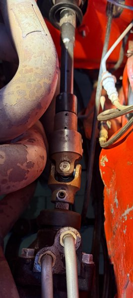

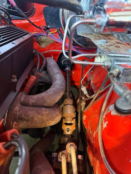

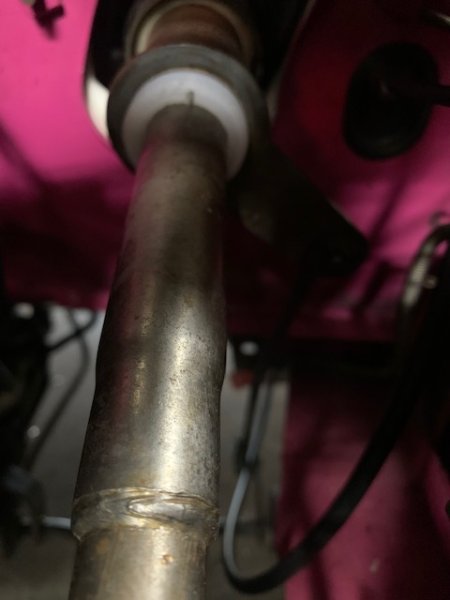

Hello, does the B-body steering column have a lower bearing? Mine doesn't have one, and I haven't found any information about it online. I've installed the Borgeson steering box, and the angle from the shaft to the gearbox looks odd. The steering column, and therefore the shaft, are positioned via the column bracket, so you can't install it incorrectly. I don't understand this at all.
The column to box angle seems to vary from car-to-car, presumably because of the inconsistent placement of the K-member bracket. I just installed that box, and my angle isn't as severe as yours, but others have a similar alignment.
As far as the shaft not being centered in the column tube, you can loosen the three firewall bolts and center it up. I did that to center it up at first but later went back and installed a cartridge bearing. That forces it to be centered, but more importantly, prevented the blast of hot air coming up my column tube and making the drive uncomfortable.
Okay, if I center it with a cartridge bearing, the angle to the steering gear will be even more unfavorable.
Using the three screws on the firewall is an option; I'll give that a try.

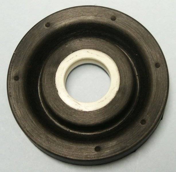

2266738 SEAL STEERING COLUMN 62-66 A/B​

Ist’s a 72‘ Plymouth Satellite

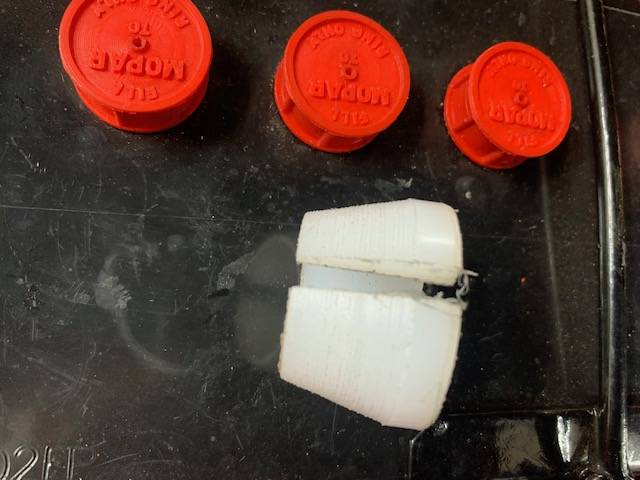

71 & up don't use a bearing, the plate can be centered by loosening the three bolts...
I machined a tool that makes centering easy...

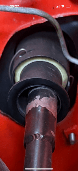

I found this bearing worked perfectly on the steering shaft on my 71 Runner. I bought it from Amazon.
Just remove and discard the snap ring, it's not needed.
Then add the rubber seal that gtx6970 posted above.
You can see the seal in this photo.
I also ordered the bearing, but it is for a 3/4" shaft. In my case, the shaft has 1" at the point where the bearing should be.
