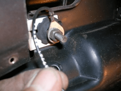

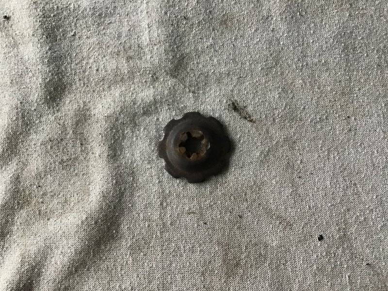

1. I dropped the steering column on my 68 Charger and noticed this star-washer laying on the floorboard and I think it came down as a part of the grounding wire from the steering column to the plastic slide based on the picture below from a 72 Roadrunner. Am I right?

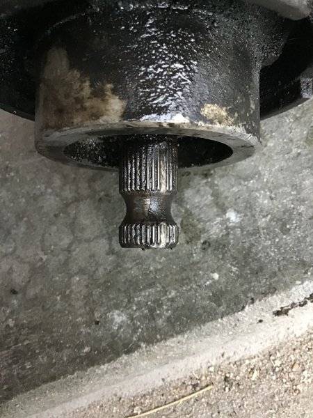

2. In the process of trying to figure out the location of the star washer but after I installed my new power steering box (from Steer and Gear) and AFTER i put my glasses on to look at the old one closely, I noticed the flat groove on the old steering box’s spline. I had to tap it / hammer the new one on and it looks secure but thought I’d ask if it is worth backing the couple off to realign it or would I just risk damage? Also, my steering wheel wasn’t clocked perfectly to begin with and it still isn’t but the wheels are currently straight according to my eyeball test.

1. Those washers go on the studs that hold the “steering column plate” in that holds the steering column up.
2. I’d want to re-align the coupler. That might be why your steering wheel isn’t straight
That blind spline should be straight up. That way, the sector shaft is centred so you have the same amount of movement each way. Also, the "on-center" aid will now be functional to keep your car from wandering while driving straight ahead. There is also a blind spline at the steering wheel end of the shaft, so there is only one way to install the wheel.
Thanks for your help. It's all straightened out and the steering wheel is clocked in better than before I started. Now I'm off to the wiring . . .
And if your steering wheel is not perfectly straight, it is aligned with your tie rod adjusters.
There should be a second nut with the serated back for the ground wire.
