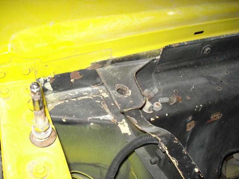

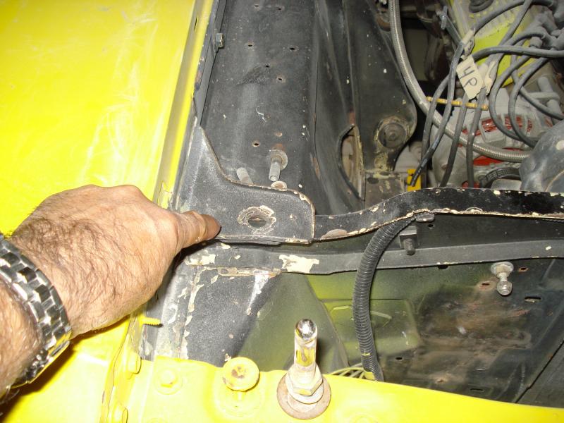

hey guys. So working on my 68 Superbee and for some reason the old owner drilled holes in the hood and added hood pins next to the hood stops. I did noticed that there are some brackets about 4" back from the hood stops. They have holes that are a perfect size for hood pins. So is this for hood pins? I want to keep the pins but would like to have them in the proper location. I'm running a steel hood with hinges (not a lift off hood). Help...what are these brackets for?
ok here is a pic

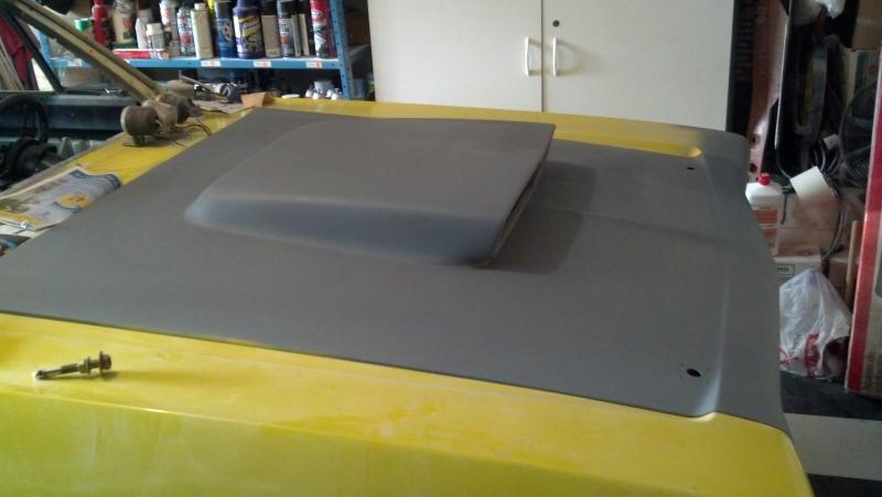

Thanks Super Rob. The link was perfect, even showed where to attach the lanyard. I just finished glassing my scoop to the steel hood. Guess I need to weld up the existing holes and drill new ones. hood scoop.jpg
