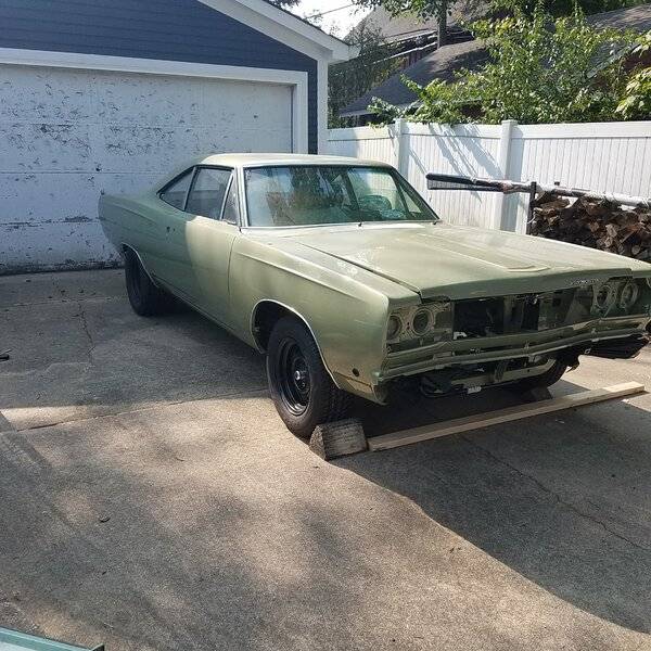

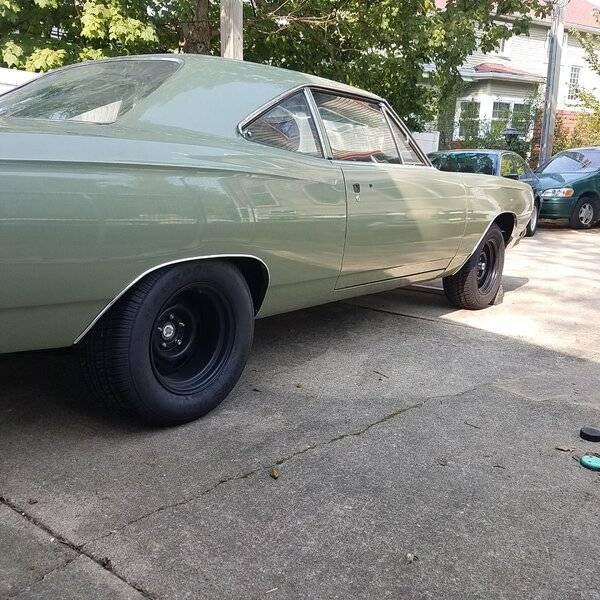

Chrysler called it Meadow Green
Dodge called it Medium Green
Plymouth called it Avocado Green
All have the same paint code.
I believe I can dig up the formula if this is the color you are referencing.

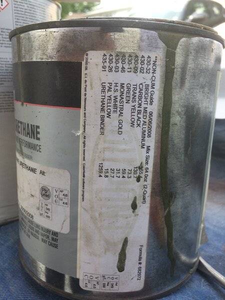

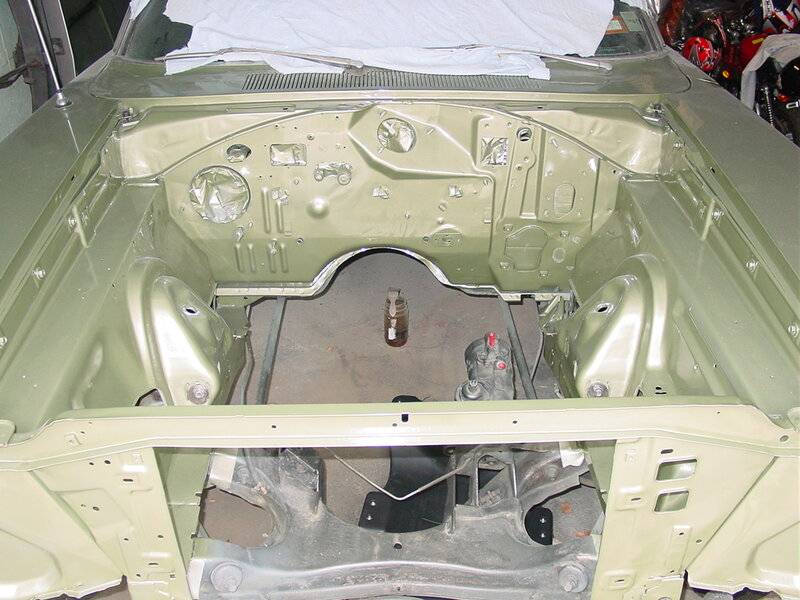

I used this single stage Dupont for the engine compartment. Color tints should be the same as a base coat. I have 6 quarts of original lacquer if he's interested.
