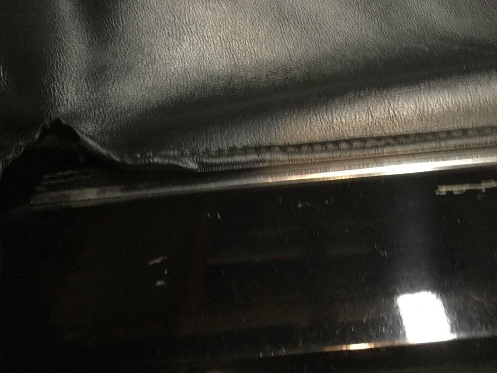

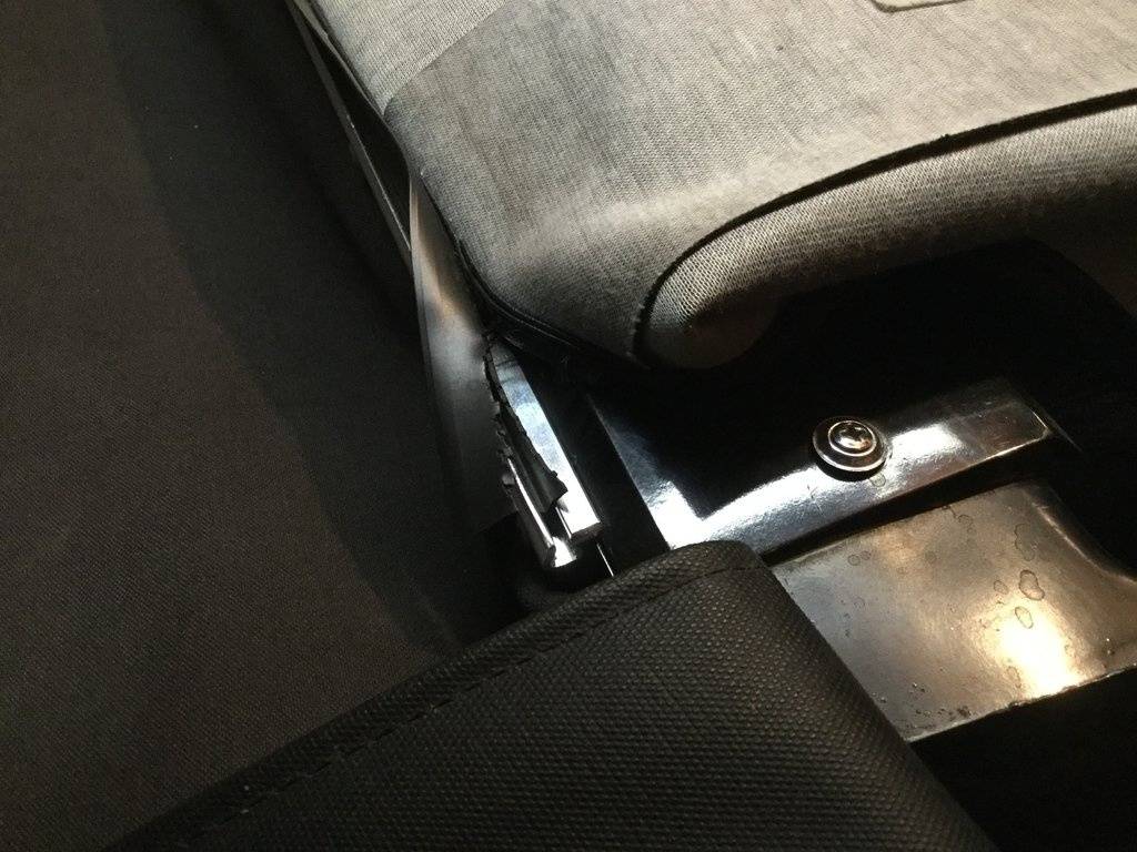

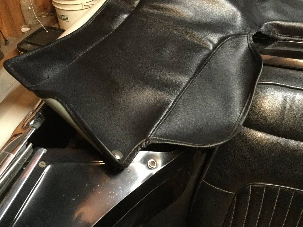

Anyone have any close up photos of their top boot and how it is attached?
Should be a welt on the front of the boot that slides into the channel.
Yes. Sewen to the boot is a piece of rubber that slides in the channel. The wings snap on the rear upper panel.
