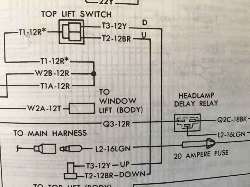

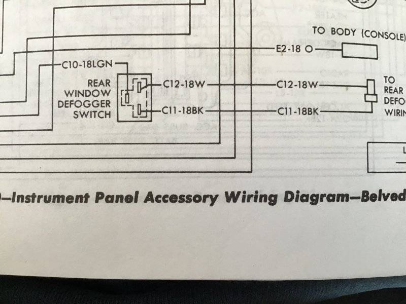

Defogger switch has off low high, so 3 clicks total. It will stay where you put it. that's what you have based on the wire colors.
Top switch is spring loaded to the center. It can be pushed forward or pulled back and it returns to center when released. Each switch has different color wires. Top switch has red and yellow wires.

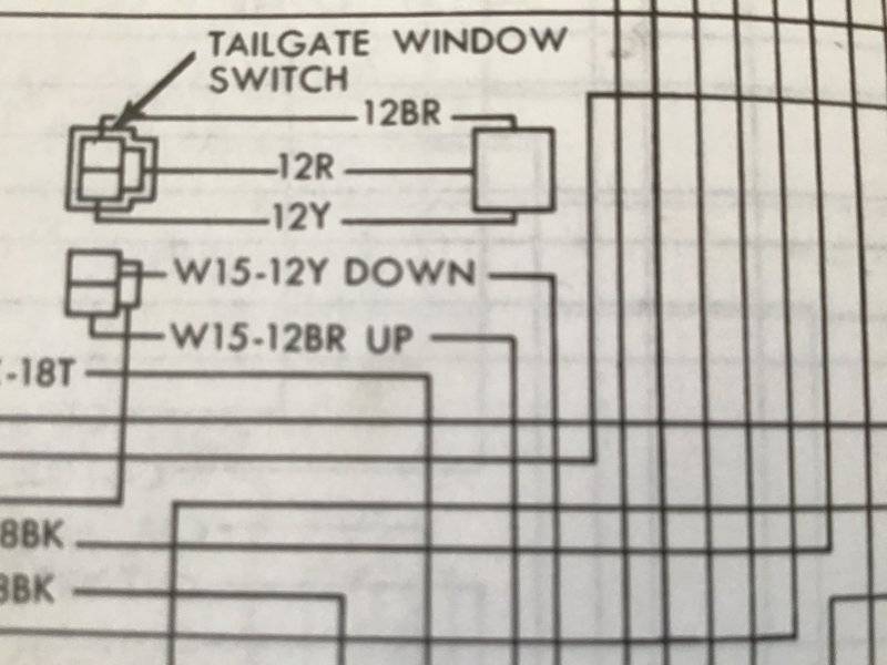

Possibly convertible top and station wagon rear window switch? Each would have up and down with off in the centre. Is it spring loaded?
It's clear as day, his wire color tell us it's a defroster switch.
White
Black
Light green
Top switch and rear window both use same colors
Red
Yellow
Brown
Someone with a parts book can verify if it's the same switch.
