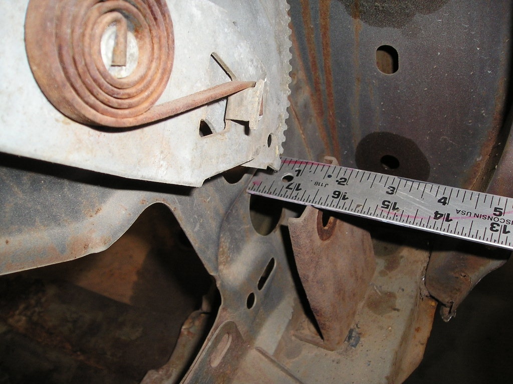

Does anyone have pics of the door glass channels and brackets for the rear/jamb area on the convertible? I am having alot of trouble getting the windows to go down without binding and am wondering if I have the wrong channels or mounting brackets.Any help appreciated. Thanks
Ok I believe the 1967 charger rear channel run is the same with the exception of a window stop.So I will modify the channel for a stop.

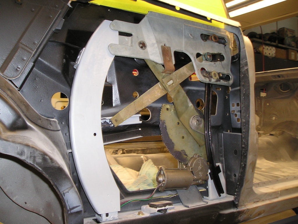

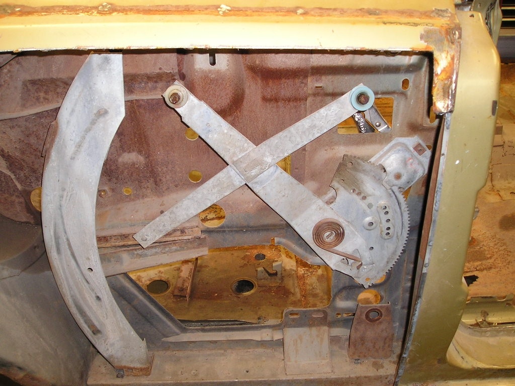

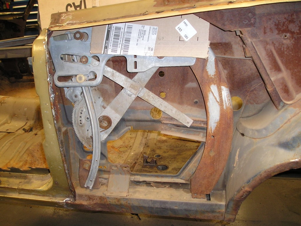

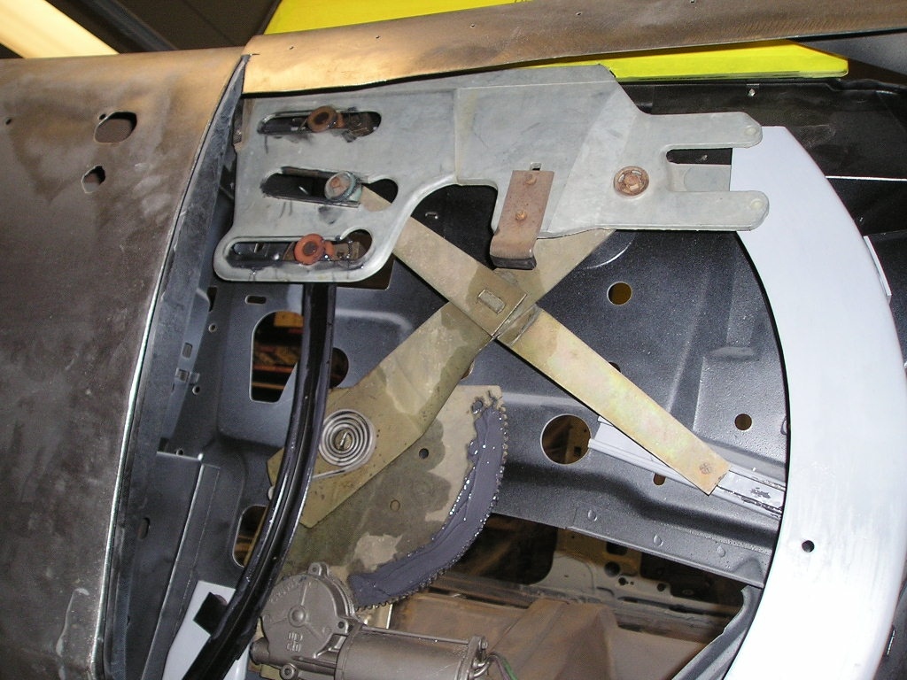

These help ? It's a '68 Sport Satellite convertible, power window.
Actually I was talking about the door track/channels but great pics and thanks for that.I am sure they will come in handy for lots of us again.Thanks and sorry I wasn't more clear.

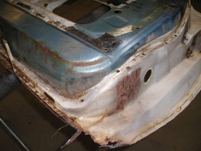

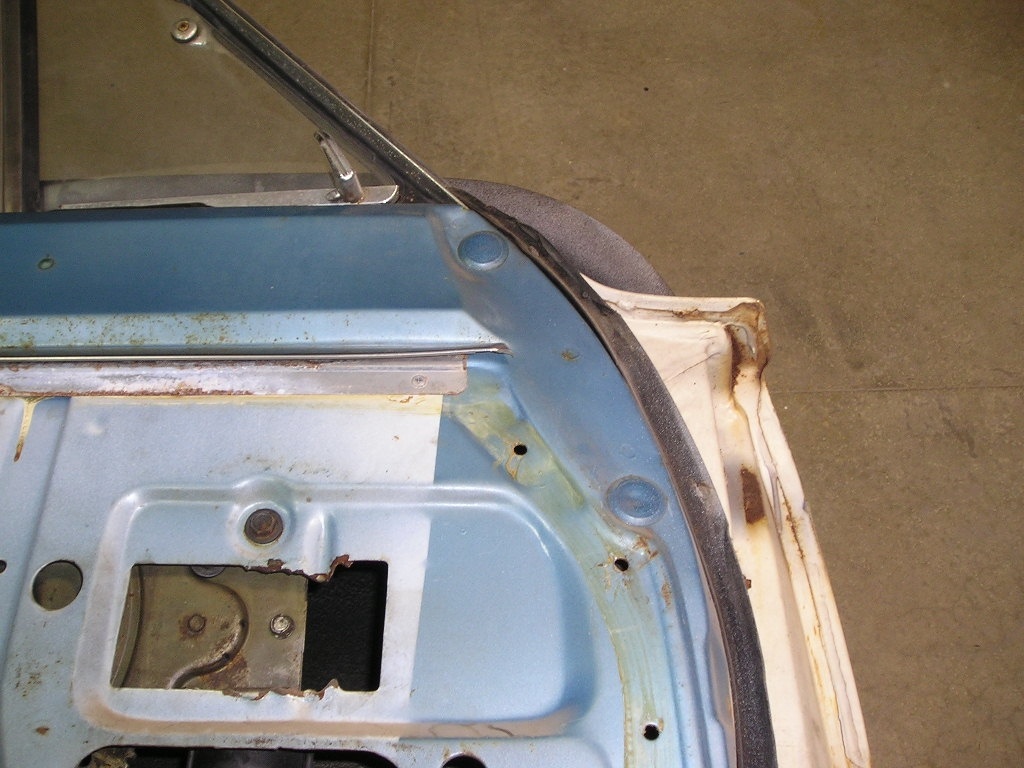

Here you go. The factory (rather crudely) just hogged out the area where the switch goes.
Thanks for the pics.That is what I was afraid of.Nu Relics regulators bolt in where the crank regulator was.Now I gotta get creative. Thanks again.
