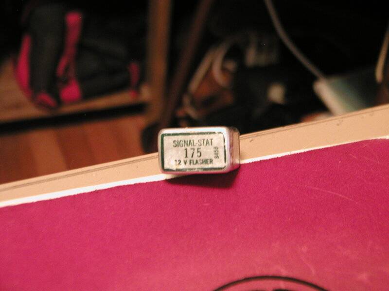

Do The Flasher Relays Located On Either Side Of The Steering Columns Have The Same Part Numbers?
Also Does Anyone Have The Numbers. Thank You

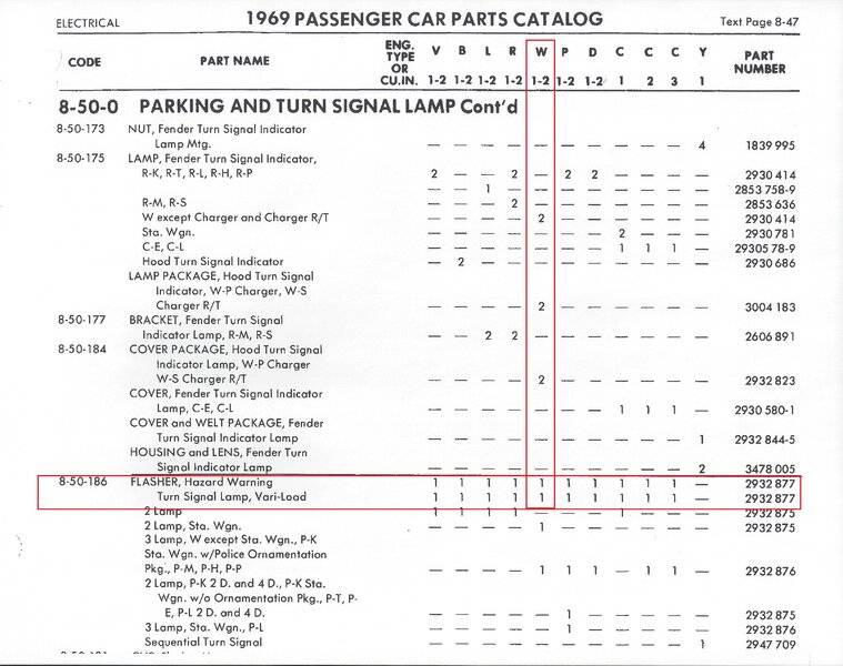

They are different part numbers according to the fsm, but it doesn’t list part numbers.
Different part number, but function about the same as any generic flasher if your just looking to get it working.
The flash timing may differ based on current draw, that is why they need to be replaced stock units with electronic units if using LED bulbs (less current).

Question #1 - I believe they are the same, Signal-Stat 175's. The other number on them I believe is a date code, in this case, S458 which is most likely the 45th week of 1968. This would be correct for the car ('69 Coronet) in which it came out of, I have several others where the date code corresponds to the SPD of the car they came out of as well. Not sure of the significance of the "S" in front of the date code.
Question #2 - It appears that the "part number" is "175" which is Signal-Stat's number, not Chrysler's number.
