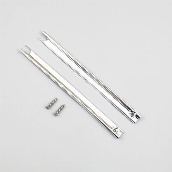

I have a 69 Charger and I am trying to install a set of the sill plate extensions shown below. Does anyone have some good pictures of how they install correctly and fit into the base of the rear seat side panel. My side panels seem to bend over onto the rug at the bottom not allowing them to install. Any help and pictures is appreciated.
Thank you!

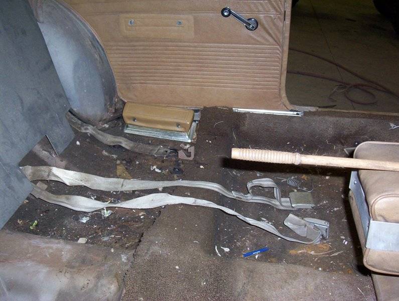

This was my car when I pulled it apart. I had a hard time when I put it back together. Once you find the holes they will start to fit.
View attachment 1426785 Thank you. do you have a pic of the big sill plate sitting on top of the extension so I can see how that fits on it
Also it’s tough to tell from the pic. Does the U shape end go towards the front or the rear?
View attachment 1426785it’s tough to tell from the pic. Does the U shape end go towards the front or the rear?
There is a left and a right. The "fork" goes under the sill plate to pick up the sill plate screw. The "hole" goes to the rear and screwed into it's hole in the floor.
