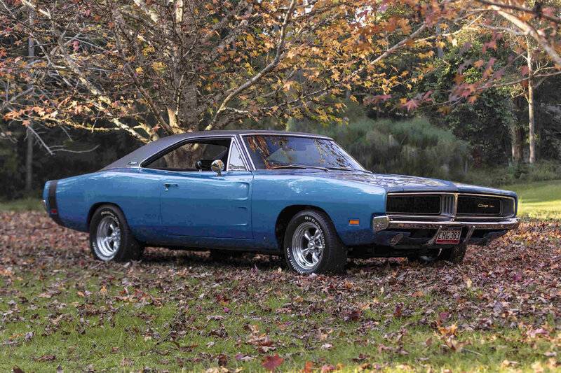

I love my QQ1 even though it's a 68 colour
Hemi orange with magnetic "01" and flags an option?[/QUOTE
No way Its getting magnet s is getting paint on if it goes that way !!!!
But I think I'm stuck between the green and a deep brown I like the 68 above that is beautiful !
