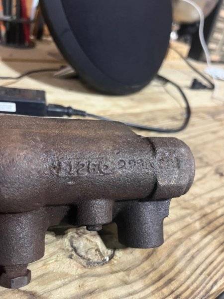

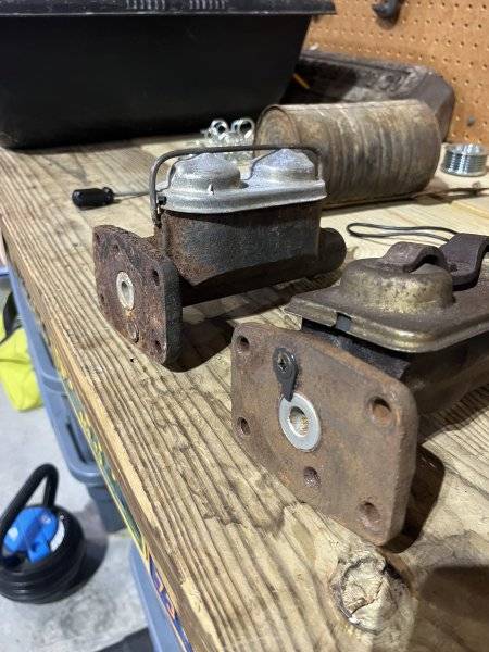

I had to use an adapter for the front line.. but the system had been hacked up with one of those shitty Chinese power brake kits , so I can't confirm what was original

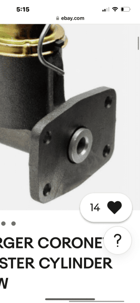

Well crud. Wondering if that’s why it’s not listed in the compatible cars list. I ordered a new factory brake line kit from Classic Industries. Will see if it shows the connection sizes somewhere and I can cross reference with the MC36283 product.
The Mopar master cylinder outlet sizes were pretty universal back in the late 60s/early 70s timeframe.
9/16-20 front outlet and 1/2-20 rear
