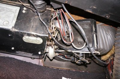

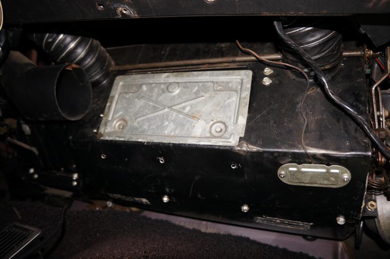

Sorting a car I recently acquired. The blower motor seems to work on Hi. Slow doesn't seem correct. The motor does turn slow when ignition is in the on position and no matter what I do the only change on the speed control it is full on or the slow which I think was 5 volts. I cannot get it to turn off. I am trying to find the blower motor resistor, but its nowhere to be found. BTW I did look for loose wires on the switch. Also what voltage will the blower motor get while on low? Any help appreciated.

It is located on the left side of the left defroster outlet. It sounds like yours may have failed or is not connected. I see there is a used one on Ebay. I don't know what the resistance is supposed to be but I have seen some new ones go for over $100.00. Not sure if anyone is rebuilding them but here is a pic of the location on the heater box.

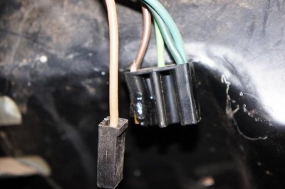

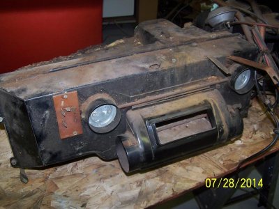

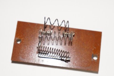

I found it over there hiding behind the hose. It seems fine. I did find a slightly melted connector. I think I also have an intermittent connection at the speed switch. Does anyone know if new switches come with the wires and connector?

I'd say you found part of the problem. Put a new connector on that wire and find a good plastic part to replace the melted one. When I say you found part of your problem, I mean, you need to check out your blower motor. That is what I believe caused the over heating of the connector. Probably at the switch also. When the motor gets tired and dirty, it takes much more current to run it. That is what causes the overcurrent at the switch and resistor. Running a tired blower motor on high is what overheats the connectors.
You may have burned the switch also as that is what usually fails first.
