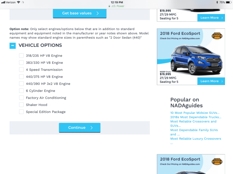

im asking because i am looking up prices on nadaguides and there you can drop in an 440 in a normal charger for example, so if that for example is really available i am asking myself what are the advantages of the road & track package???
The NADA guides site is wrong. I will mention a few of them. You cannot buy a normal 1969 charger with a 440 engine. That was never available. But you can add that on the NADA website.
They have it so you can add a 440 engine in 1970 Charger R/T. It falsely adds 30% to the car on that site. Well that car is standard with a 440 engine do you should not add it in that car and raise the price, it’s already included in the price.
Also add a 6 cylinder engine to a Charger R/T-we know that’a not available.
You can also add a shaker hood, not available in a Charger, but you can add one to the price on NADA. I chose 1970 to show the shaker hood for a B-body is adding 10% to the car.
