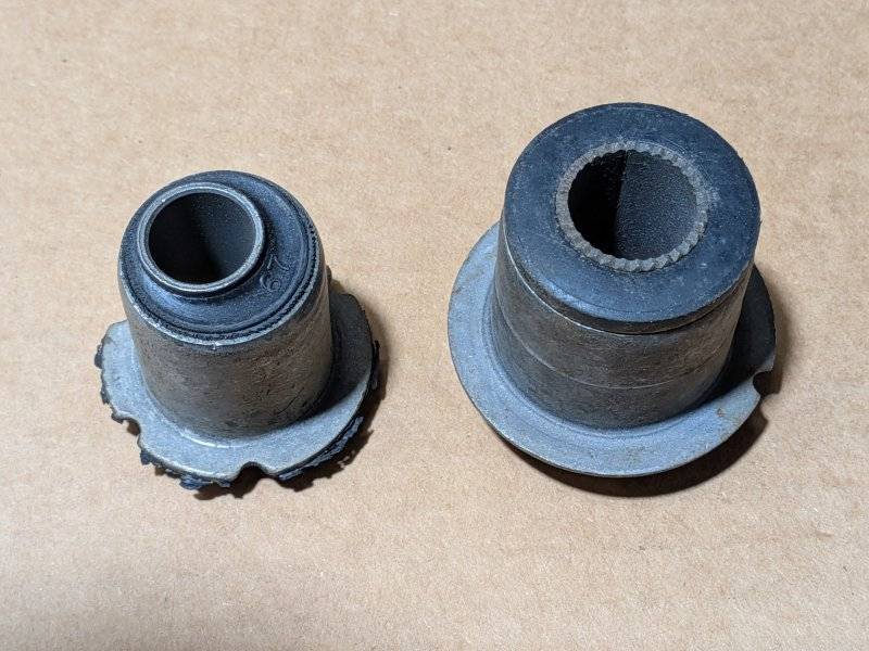

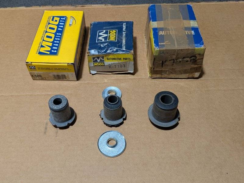

The Moog K-7103 upper control arm bushings do not fit the 1973 Charger. 1973 - 1979 B-bodies, and 1979 - 1981 R-bodies use a larger bushing (Moog K-7058) with their different adjustment design.
The following image shows the K-7103 bushing with the K-7058 bushing plus the stock type bushing used on 1972 and earlier B-bodies, as well as A-bodies and E-bodies.:
The following image shows the K-7103 bushing with the K-7058 bushing more closely:
The inner and outer diameters are larger on the later bushing as well as other differences with washers, et.al.

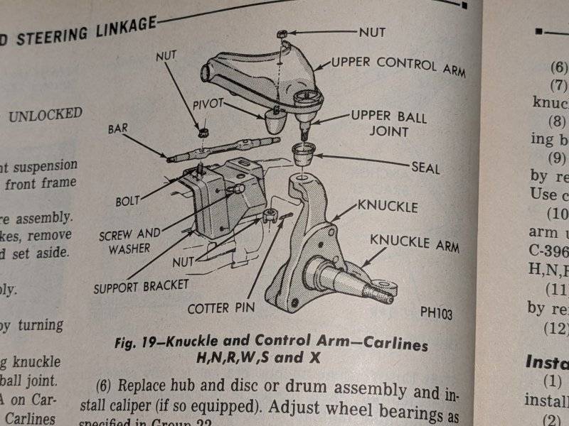

To allow more adjustment movement, the slots in the support bracket can be lengthened, but minimize material removal to prevent any weakening or too much removal of surface mating area at the support bracket adjustment bar bolt mount. The following image shows the support bracket and slots with the other suspension components:

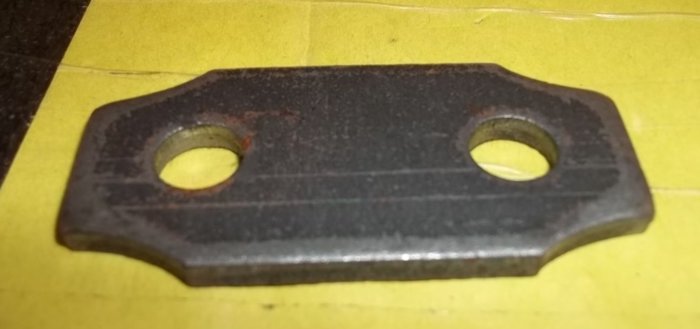

Chrysler released a package in 1980 to allow more positive camber adjustment on affected 1973 - 1980 models. Lack of enough positive camber adjustment could occur with possible frame sag when these cars were still relatively new, although it was more of an issue on F-bodies. The package consisted of two shims to place under the support plate to move it outward allowing more positive caster adjustment. This will lessen negative camber adjustment and alter caster adjustment range.
The following images show the technical service bulletin (TSB), describing the correction package:

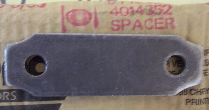

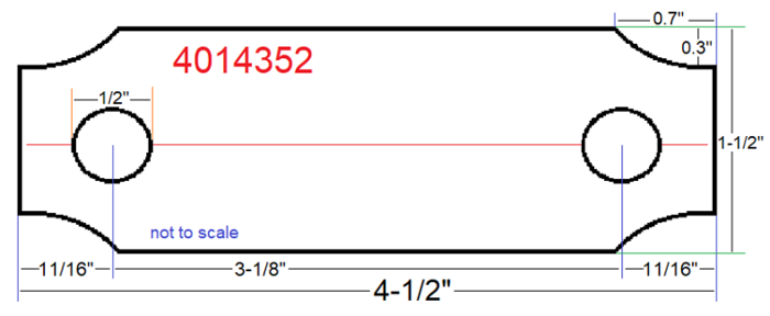

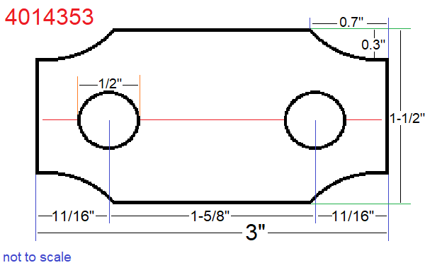

The following images show the shims and drawings from BudW on For FMJ-Bodies Only:
4014352
4014353
Interesting.
Looks like those could be made relatively easily.
4014352
4014353
Thanks for taking the time to post all of this, This is very good info and This is what I was going to look into doing, looks like the spacers may be 1/4 or 3/8 thick
