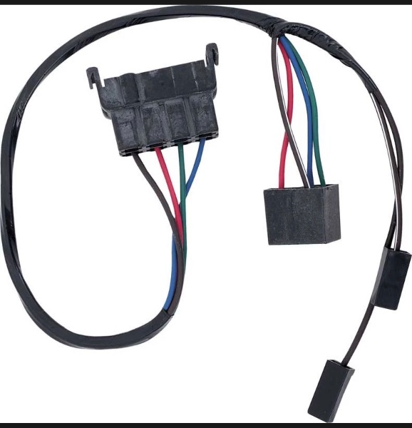

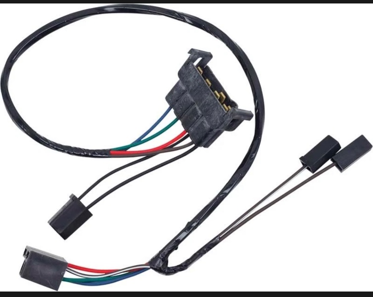

Im checking at classic industries and there 2 types of harness:
MD4510:
And MD4509:
Do you know the right ones for a 69 charger 383 please?
Thanks in advance
Hello to all
MD4510:
And MD4509:
Thanks in advance
Both of the pictured wiring harnesses are for a two speed motor, and that part of the wiring is the same between the two.
MD4510 with the extra two wires and connector is for the switch wiring for the reverse lamp switch that routes through the bulkhead.
The MD4509 is for 1968 with an automatic transmission that does not use the extra two wires through the bulkhead because the the reverse lamp switch is on the steering column or console shifter inside.
The MD4510 is for a 1968 with manual transmission that routes the reverse lamp switch wires through the bulkhead, or for a 1969 with either transmission. The 1969 models used the same manual transmission switch routing but were now using the new three terminal neutral safety switch with the reverse lamp switch combined in the automatic transmission, so the additional wires were also now used for the automatic as well.

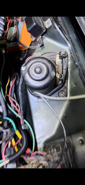

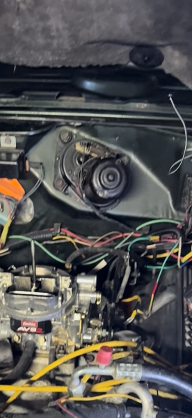

Great reply thank you. Mine its automatic trans
Other pic of windshield motor:
He beat me to it, I thought that the top picture had something to do with the reverse light switch 4-speed and light under the dash. The bottom for an automatic.
The harness is attached to the 3-speed wiper motor. Not by plugging it into like the 2-speed.
